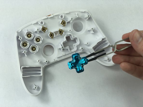

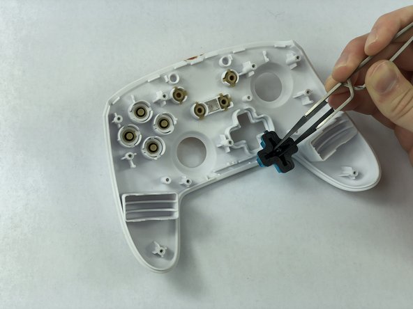

  5. PowerA Enhanced Wireless Controller Directional Pad Replacement, Directional Pad: crwdns2935265:05crwdnd2935265:01crwdnd2935265:03crwdne2935265:0 PowerA Enhanced Wireless Controller Directional Pad Replacement, Directional Pad: crwdns2935265:05crwdnd2935265:02crwdnd2935265:03crwdne2935265:0 PowerA Enhanced Wireless Controller Directional Pad Replacement, Directional Pad: crwdns2935265:05crwdnd2935265:03crwdnd2935265:03crwdne2935265:0
    • Use the rubber tweezers to grab the center of the directional pad and pull it out by pinching its center.
