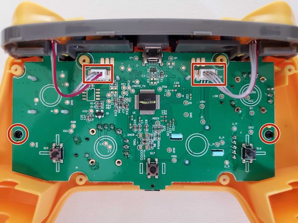

  2. PowerA Enhanced Wired Controller for Nintendo Switch Disassembly, Remove motherboard: crwdns2935265:02crwdnd2935265:01crwdnd2935265:02crwdne2935265:0 PowerA Enhanced Wired Controller for Nintendo Switch Disassembly, Remove motherboard: crwdns2935265:02crwdnd2935265:02crwdnd2935265:02crwdne2935265:0
    • The front shell has mouldings for rumble motors but the motherboard does not have any apparent connections for them
    • Unplug the two shoulder button connectors
    • Remove the two screws that hold the motherboard in place

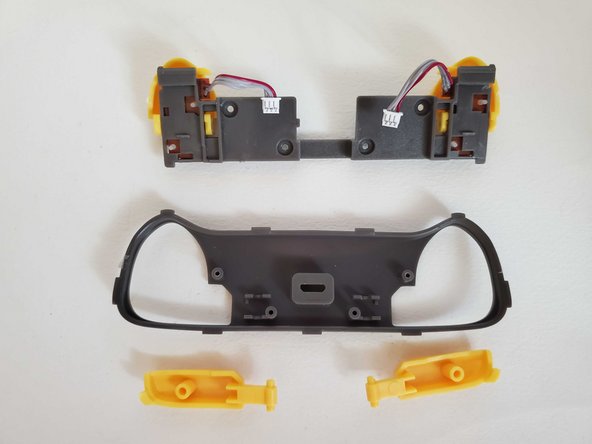

  4. PowerA Enhanced Wired Controller for Nintendo Switch Disassembly, Shoulder buttons: crwdns2935265:04crwdnd2935265:01crwdnd2935265:02crwdne2935265:0 PowerA Enhanced Wired Controller for Nintendo Switch Disassembly, Shoulder buttons: crwdns2935265:04crwdnd2935265:02crwdnd2935265:02crwdne2935265:0
    • There are two more Phillips screws holding the button assembly together
    • Nothing holds the L and R bumpers but the ZL and ZR triggers are on a hinge

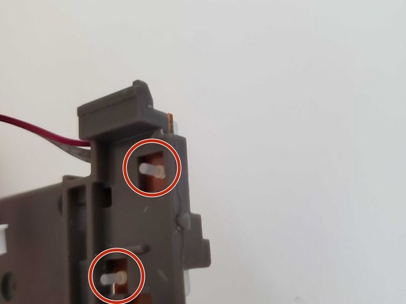

  5. PowerA Enhanced Wired Controller for Nintendo Switch Disassembly, Remove the ZL and ZR triggers: crwdns2935265:05crwdnd2935265:01crwdnd2935265:02crwdne2935265:0 PowerA Enhanced Wired Controller for Nintendo Switch Disassembly, Remove the ZL and ZR triggers: crwdns2935265:05crwdnd2935265:02crwdnd2935265:02crwdne2935265:0
    • Small plastic posts hold the ZL and ZR triggers in place. Gently pry the triggers off the posts using a plastic pry tool or fingernails. These are easy to break so be gentle here. The elastomer underneath is held on by little posts that stick through the plastic. Removing them is easy but pushing them back in is a challenge

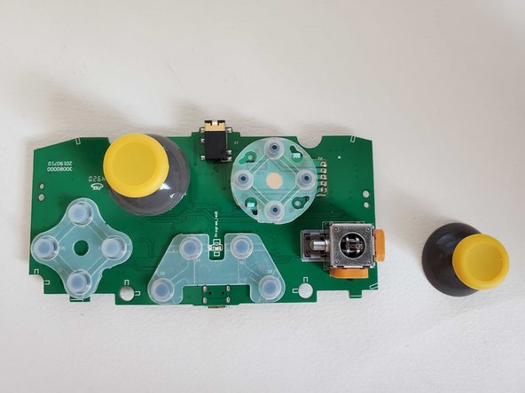

  6. PowerA Enhanced Wired Controller for Nintendo Switch Disassembly, Main buttons and sticks: crwdns2935265:06crwdnd2935265:01crwdnd2935265:01crwdne2935265:0
    • The elastomers are held in with little posts that go through the board. The sticks are soldered so are not easy to remove

My rubber pads have worn out. I've been looking for replacement pads, but no one seems to sell them.
Radiohead - crwdns2934203:0crwdne2934203:0
You can probably order rubber pads for a ps4 controller and cut them to fit. Not ideal but they are easy to find online and relatively cheap
