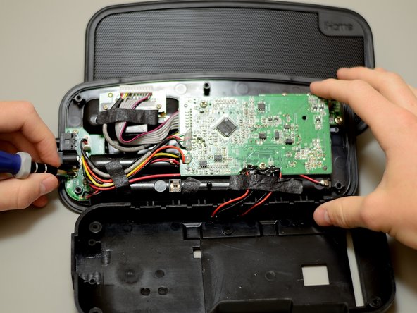

    • Remove these four 9 mm screws from the plastic casing; you will need a Phillips #2 driver to do this.
    • Remove the flanged 9 mm screw from the counterweight; you will need a Phillips #2 driver to do this.
    • Lift and remove the counterweight.

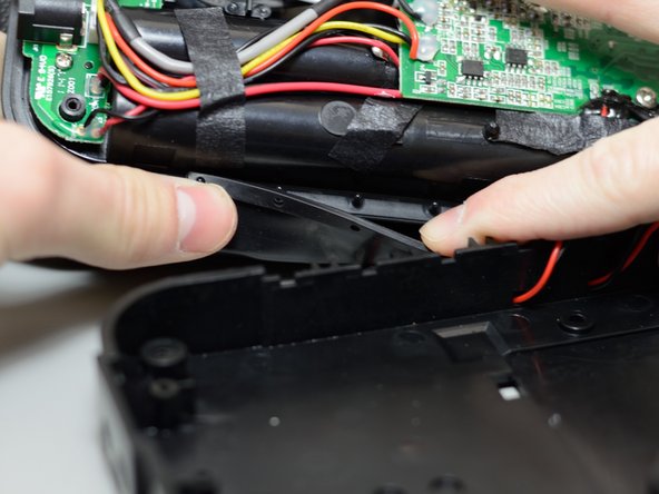

    • Lift and remove the plastic casing.
    • Note: It is best to lift the casing starting from the side without the protruding 3.5mm audio port and power port.
    • Reminder: During this process, a rubber cover will likely be dislodged. Make sure to re-seat this cover on the small pegs before putting the plastic casing back on.

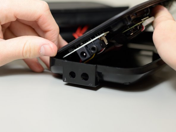

  4. Power and 3.5 mm Audio Adapter Jacks Replacement, Power and 3.5 mm Audio Adapter Jacks: crwdns2935265:04crwdnd2935265:01crwdnd2935265:01crwdne2935265:0
    • Firmly and cautiously unplug the two white 3-pin connectors from the printed circuit board.

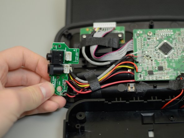

    • Remove the two 5mm screws holding the power and 3.5mm jack PCB onto the rest of the device; you will need a Phillips #1 driver to do this.
    • Lift the PCB away from the rest of the device.
  6. Power and 3.5 mm Audio Adapter Jacks Replacement: crwdns2935265:06crwdnd2935265:01crwdnd2935265:01crwdne2935265:0
    • Desolder the two black and two red cables from the board.
    • These wires will need to be soldered to the replacement board when reassembling the device.
    • You can refer to iFixit's guide or this informative video for more information on soldering.
