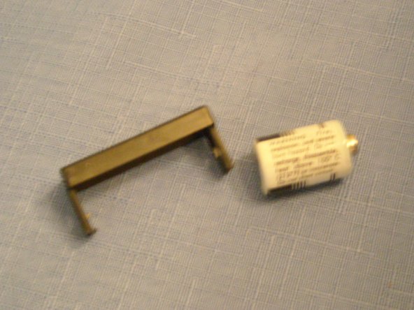

    • The PRAM battery!
    • Remove the housing by pulling it out and then take the battery out.

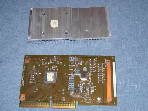

    • The processor, firmly grasp and pull out.
    • Remove the 4 #1 Phillips screws
    • And push the 4 tabs off of the board

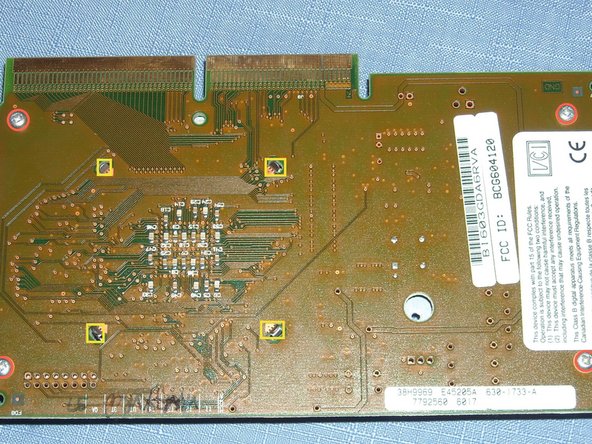

    • Any video card or usb card, mine happens to be an ethernet 10/100 card.
    • Unfortunately there are 6 spaces but only 3 slots on the motherboard :(
    • Remove the #1 Phillips screw and pull the card out.

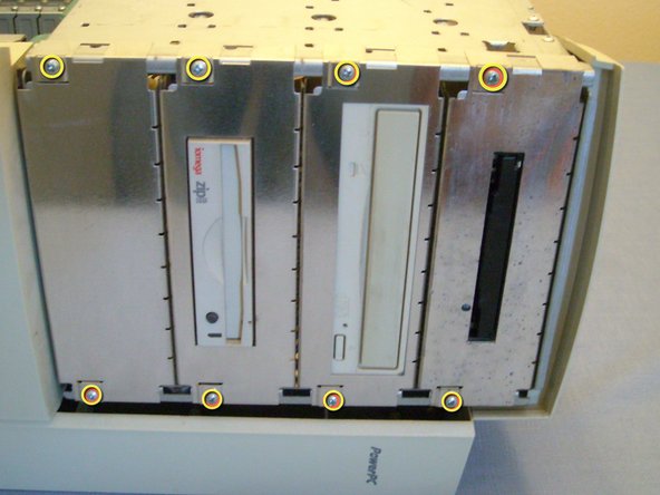

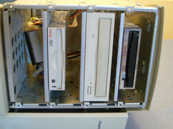

    • Moving on to the CD, ZIP, and Floppy drives (best to close computer now)
    • Remove the bezels and if I had the top one remove that too.
    • Remove the 6 phillips screws and pull the metal frames out.
  11. Power Macintosh 8600(250) Teardown: crwdns2935265:011crwdnd2935265:01crwdnd2935265:03crwdne2935265:0 Power Macintosh 8600(250) Teardown: crwdns2935265:011crwdnd2935265:02crwdnd2935265:03crwdne2935265:0 Power Macintosh 8600(250) Teardown: crwdns2935265:011crwdnd2935265:03crwdnd2935265:03crwdne2935265:0

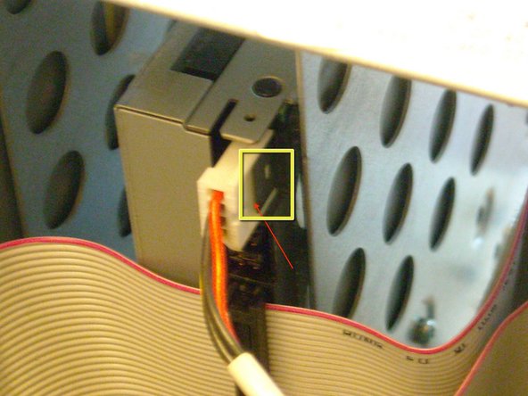

    • Remove the data and power cables
    • Pay special attention to this one, it has a clip on it, it helps to use a flathead or a spudger.
    • Pull the drives out of the bay.
