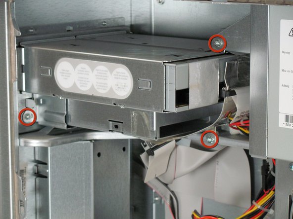

  4. Power Mac G4 Quicksilver Power Supply Replacement, Optical Drive: crwdns2935265:04crwdnd2935265:01crwdnd2935265:01crwdne2935265:0
    • The optical drive is in the top left corner of the case.
  5. Power Mac G4 Quicksilver Power Supply Replacement: crwdns2935265:05crwdnd2935265:01crwdnd2935265:02crwdne2935265:0 Power Mac G4 Quicksilver Power Supply Replacement: crwdns2935265:05crwdnd2935265:02crwdnd2935265:02crwdne2935265:0
    • There are four screws to be removed.
    • The first screw can be seen in the first picture.
    • The remaining three screws can be seen in the second picture.

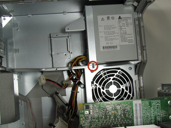

  13. Power Mac G4 Quicksilver Power Supply Replacement, Power Supply: crwdns2935265:013crwdnd2935265:01crwdnd2935265:01crwdne2935265:0
    • The power supply is in the upper right corner of the case.
  14. Power Mac G4 Quicksilver Power Supply Replacement: crwdns2935265:014crwdnd2935265:01crwdnd2935265:02crwdne2935265:0 Power Mac G4 Quicksilver Power Supply Replacement: crwdns2935265:014crwdnd2935265:02crwdnd2935265:02crwdne2935265:0
    • There is a total of four screws to be removed.
    • The first three can be seen in the first picture.
    • The final screw can be seen in the second picture.
