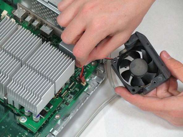

    • First you want to remove the fan. Remove the two screws on the back of the computer in the upper left hand corner.
  9. Power Mac G4 Quicksilver Central Processing Unit Replacement: crwdns2935265:09crwdnd2935265:01crwdnd2935265:02crwdne2935265:0 Power Mac G4 Quicksilver Central Processing Unit Replacement: crwdns2935265:09crwdnd2935265:02crwdnd2935265:02crwdne2935265:0
    • Remove the fan unit by pulling straight up and out.
    • Be carful not to rip out the cord still attached to the motherboard. Remove it gently.

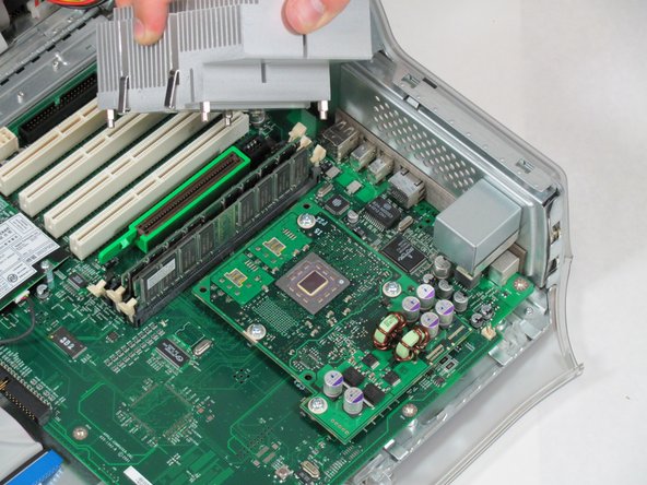

    • You need detach the heat sink from the CPU. Locate the four clamps holding it down, two on each side.
    • Taking off the clamps can be difficult. Use a screwdriver to push down on the top of the clip. Then insert a spudger below the heat sink to pull it away from the board, releasing the heat sink.
  11. Power Mac G4 Quicksilver Central Processing Unit Replacement: crwdns2935265:011crwdnd2935265:01crwdnd2935265:02crwdne2935265:0 Power Mac G4 Quicksilver Central Processing Unit Replacement: crwdns2935265:011crwdnd2935265:02crwdnd2935265:02crwdne2935265:0
    • Pull the heat sink up and off of the CPU.

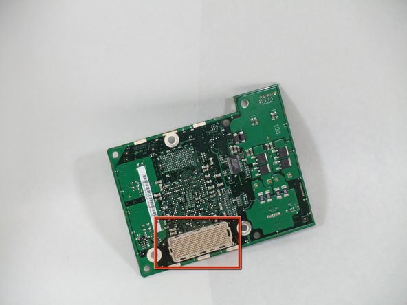

    • Remove the four screws holding the CPU to the motherboard.
  13. Power Mac G4 Quicksilver Central Processing Unit Replacement: crwdns2935265:013crwdnd2935265:01crwdnd2935265:02crwdne2935265:0 Power Mac G4 Quicksilver Central Processing Unit Replacement: crwdns2935265:013crwdnd2935265:02crwdnd2935265:02crwdne2935265:0
    • Now you can remove the CPU by pulling it straight up from the motherboard.
    • Be very careful when you detach the CPU. There is a connector that has hundreds of little prongs. You must not bend or break any of them! Be extremely careful.

Removing graphics (video) card is not necessary. Also, removing the clips which retain heat-sink can be accomplished by using a flat-blade (-) screwdriver to carefully pry them from the finned aluminum assembly. Other than these two suggestions, guide is succinct and accurate.
