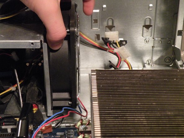

  15. Power Mac G4 MDD System Fans Replacement, System Fan: crwdns2935265:015crwdnd2935265:01crwdnd2935265:02crwdne2935265:0 Power Mac G4 MDD System Fans Replacement, System Fan: crwdns2935265:015crwdnd2935265:02crwdnd2935265:02crwdne2935265:0
    • You may find removing the system fan is unnecessary to remove the power supply cable from behind it, but if you're unfamiliar with how the power supply cable is situated behind the fan, this step is useful in seeing this.
    • Disconnect the optical drive IDE/ATA-33 cable from the logic board.
    • Disconnect the system fan 2-wire power cable connector from the logic board.
  16. Power Mac G4 MDD System Fans Replacement: crwdns2935265:016crwdnd2935265:01crwdnd2935265:03crwdne2935265:0 Power Mac G4 MDD System Fans Replacement: crwdns2935265:016crwdnd2935265:02crwdnd2935265:03crwdne2935265:0 Power Mac G4 MDD System Fans Replacement: crwdns2935265:016crwdnd2935265:03crwdnd2935265:03crwdne2935265:0
    • Grab the system fan by its sides and pull it up and out. The system fan is very large and loud, compared to standard sized fans.
