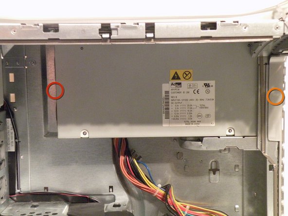

  17. Power Mac G4 MDD Power Supply Replacement, Power Supply: crwdns2935265:017crwdnd2935265:01crwdnd2935265:02crwdne2935265:0 Power Mac G4 MDD Power Supply Replacement, Power Supply: crwdns2935265:017crwdnd2935265:02crwdnd2935265:02crwdne2935265:0
    • To remove the power supply connector from the motherboard, push the top end of this clip towards the power supply connector, and pull the connector up and off the motherboard. If the connector seems to be stuck, rock it back and forth a tiny bit to loosen up the connection, then pull up again.
  18. Power Mac G4 MDD Power Supply Replacement: crwdns2935265:018crwdnd2935265:01crwdnd2935265:03crwdne2935265:0 Power Mac G4 MDD Power Supply Replacement: crwdns2935265:018crwdnd2935265:02crwdnd2935265:03crwdne2935265:0 Power Mac G4 MDD Power Supply Replacement: crwdns2935265:018crwdnd2935265:03crwdnd2935265:03crwdne2935265:0
    • Push on these two clips here to release the power cable.
    • Thread the power cable out of the small hole it comes through, at the far side of the Mac.
  19. Power Mac G4 MDD Power Supply Replacement: crwdns2935265:019crwdnd2935265:01crwdnd2935265:02crwdne2935265:0 Power Mac G4 MDD Power Supply Replacement: crwdns2935265:019crwdnd2935265:02crwdnd2935265:02crwdne2935265:0
    • Remove this Phillips screw:
    • There may be a small 2.5mm hex (not Torx) screw here on the back of the case, it must be removed if present:
  20. Power Mac G4 MDD Power Supply Replacement: crwdns2935265:020crwdnd2935265:01crwdnd2935265:02crwdne2935265:0 Power Mac G4 MDD Power Supply Replacement: crwdns2935265:020crwdnd2935265:02crwdnd2935265:02crwdne2935265:0
    • Slide the power supply towards the front of the case, and pull it out. It is a little heavy, so don't drop it on the logic board. Disconnect any drive power connectors that you may not have already connected.
  21. Power Mac G4 MDD Power Supply Replacement: crwdns2935265:021crwdnd2935265:01crwdnd2935265:02crwdne2935265:0 Power Mac G4 MDD Power Supply Replacement: crwdns2935265:021crwdnd2935265:02crwdnd2935265:02crwdne2935265:0
    • The power supply has a 24-pin connector with non-standard voltages, so dropping in a 24-pin ATX power supply without modification isn't a great idea.
    • The power supply connector has a 25V lead to drive Apple ADC displays, so though it is possible to modify an ATX power supply, it won't be able to drive ADC displays, just VGA, or DVI, though the computer will work fine (I've actually tried this).
    • It also has three 12V/5V rails to drive all six drives (four hard drives, two optical drives) simultaneously. This is the only Macintosh computer other than the Mac Pro to support six drives.
  22. Power Mac G4 MDD Power Supply Replacement: crwdns2935265:022crwdnd2935265:01crwdnd2935265:02crwdne2935265:0 Power Mac G4 MDD Power Supply Replacement: crwdns2935265:022crwdnd2935265:02crwdnd2935265:02crwdne2935265:0
    • This is also the notoriously loud AcBel 400W "Windtunnel" power supply
