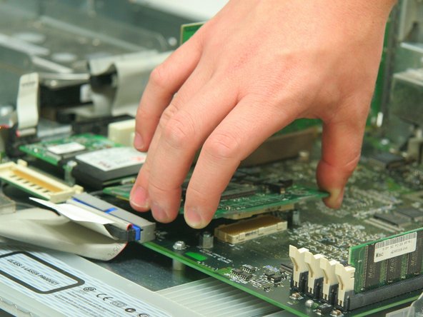

    • Pull on outer latch.
    • Lower door until it is level with your work surface.
    • Before working on the computer make sure it is not plugged into a power supply, then touch a metal object. This discharges static electricity, which could damage the computer.
  2. Power Mac G4 M5183 Processor Replacement, Heat Sink: crwdns2935265:02crwdnd2935265:01crwdnd2935265:02crwdne2935265:0 Power Mac G4 M5183 Processor Replacement, Heat Sink: crwdns2935265:02crwdnd2935265:02crwdnd2935265:02crwdne2935265:0
    • Use the spudger to pry the clips horizontally off of the heat sink.
    • Fully remove the clips by lifting upwards.
  3. Power Mac G4 M5183 Processor Replacement: crwdns2935265:03crwdnd2935265:01crwdnd2935265:01crwdne2935265:0
    • Remove the heat sink by pulling upwards, off of the logic board.
  4. Power Mac G4 M5183 Processor Replacement, Processor: crwdns2935265:04crwdnd2935265:01crwdnd2935265:02crwdne2935265:0 Power Mac G4 M5183 Processor Replacement, Processor: crwdns2935265:04crwdnd2935265:02crwdnd2935265:02crwdne2935265:0
    • Remove the 3 screws attaching the processor to the logic board using the Phillips #2 screwdriver.
    • Remove processor by pulling vertically upwards.
