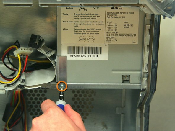

  7. Power Mac G4 M5183 Power Supply Replacement, Power Supply: crwdns2935265:07crwdnd2935265:01crwdnd2935265:02crwdne2935265:0 Power Mac G4 M5183 Power Supply Replacement, Power Supply: crwdns2935265:07crwdnd2935265:02crwdnd2935265:02crwdne2935265:0
    • Remove the 3 hex screws on the back of the case.
    • Remove the single screw on the side of the power supply casing with the Phillips #1 screwdriver.

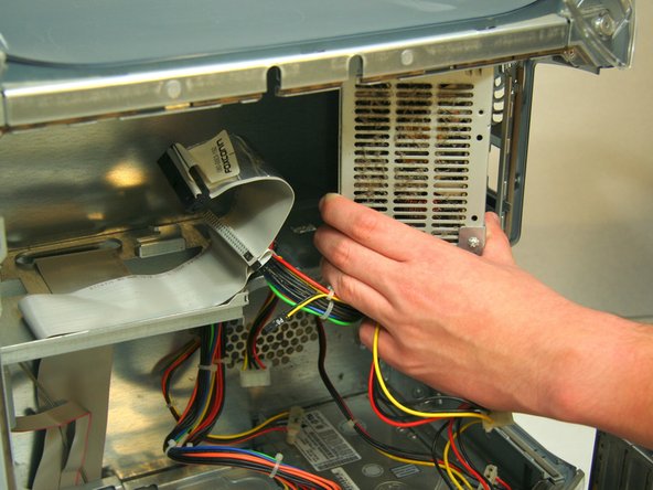

  8. Power Mac G4 M5183 Power Supply Replacement: crwdns2935265:08crwdnd2935265:01crwdnd2935265:02crwdne2935265:0 Power Mac G4 M5183 Power Supply Replacement: crwdns2935265:08crwdnd2935265:02crwdnd2935265:02crwdne2935265:0
    • Remove power cable from the logic board.
    • Remove power cable from hard drive.
    • Pull the power supply out and towards yourself.
