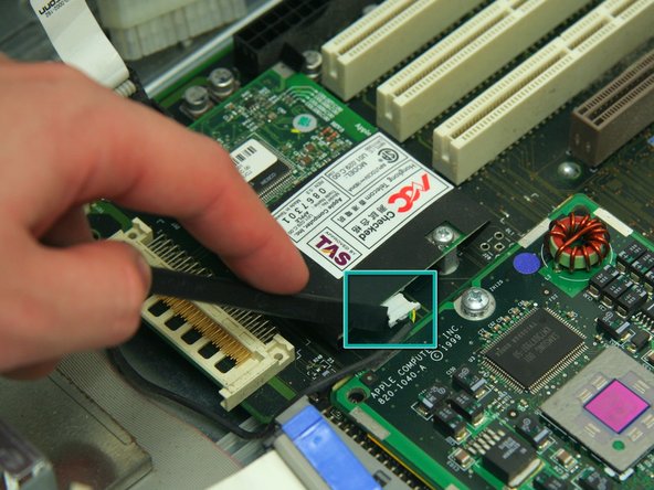

  6. Power Mac G4 M5183 Logic Board Replacement, Logic Board: crwdns2935265:06crwdnd2935265:01crwdnd2935265:02crwdne2935265:0 Power Mac G4 M5183 Logic Board Replacement, Logic Board: crwdns2935265:06crwdnd2935265:02crwdnd2935265:02crwdne2935265:0
    • Remove the six indicated cables attached to the logic board.
    • Use the spudger to remove the modem cable as indicated.

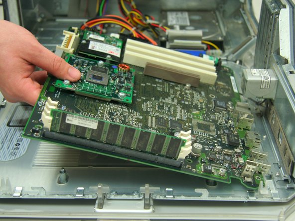

  7. Power Mac G4 M5183 Logic Board Replacement: crwdns2935265:07crwdnd2935265:01crwdnd2935265:02crwdne2935265:0 Power Mac G4 M5183 Logic Board Replacement: crwdns2935265:07crwdnd2935265:02crwdnd2935265:02crwdne2935265:0
    • Unfasten 3 Phillips screws revealed beneath the heat sink on the CPU board.
    • Carefully remove the CPU board from the Mother Board.
    • Remove the barrell nut screws from the Mother Board which held the CPU board.
    • Unfasten 3 Phillips #1 screws on Mother Board as shown in illustration 1.
    • Slide the logic board about a quarter of an inch to free it from the three retaining pins.
    • Pull upwards and outwards to fully remove the logic board.
  8. Power Mac G4 M5183 Logic Board Replacement: crwdns2935265:08crwdnd2935265:01crwdnd2935265:01crwdne2935265:0
    • After removing the (3) #2 philips screws, remove the (4) 1/4" hex nuts, then slide as directed and remove board.

Are the "hex nuts" under the processor board? Could you provide a close up picture of the "nuts?"
