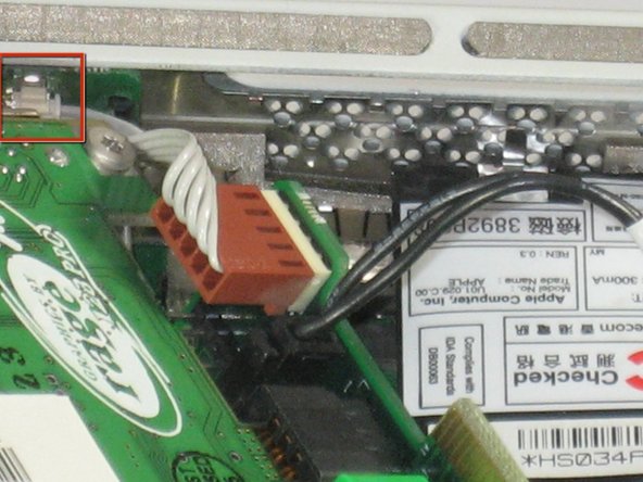

    3. Power Mac G4 Cube Modem Replacement: crwdns2935265:07crwdnd2935265:01crwdnd2935265:02crwdne2935265:0 Power Mac G4 Cube Modem Replacement: crwdns2935265:07crwdnd2935265:02crwdnd2935265:02crwdne2935265:0
      • Remove power cord from the video card.

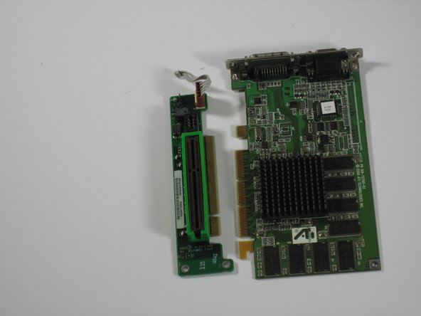

    6. Power Mac G4 Cube Modem Replacement: crwdns2935265:010crwdnd2935265:01crwdnd2935265:02crwdne2935265:0 Power Mac G4 Cube Modem Replacement: crwdns2935265:010crwdnd2935265:02crwdnd2935265:02crwdne2935265:0
      • Separate the video card from the adapter.
