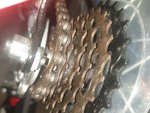

    • Switch the bicycles chain to the lowest chainring on the rear crankset of the bicycle. (If the derailleur is faulty it may not allow you to do this so you may have to manually roll the back tire while shifting the chain onto the smallest chainring).

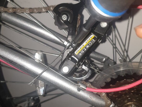

    • Loosen the rear screw which holds the derailleur against the frame of the bicycle and take out the derailleur slowly
    • (The derailleur is held in tension so be careful not to let it snap out instantly).
    • Take the chain off the crankset as well.

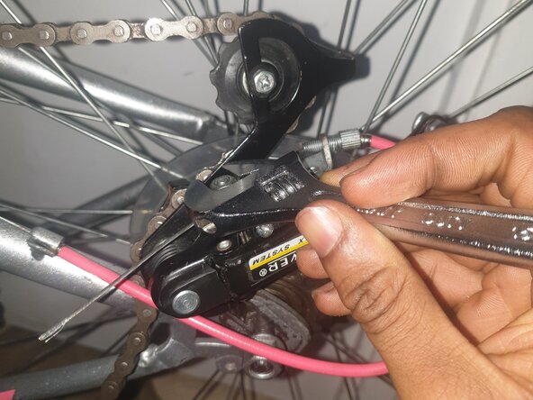

    • Use wrench to loosen bolt that holds back tension wire

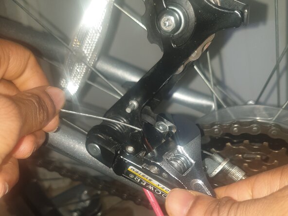

    • Turn in the direction of H on the handle until it can turn anymore

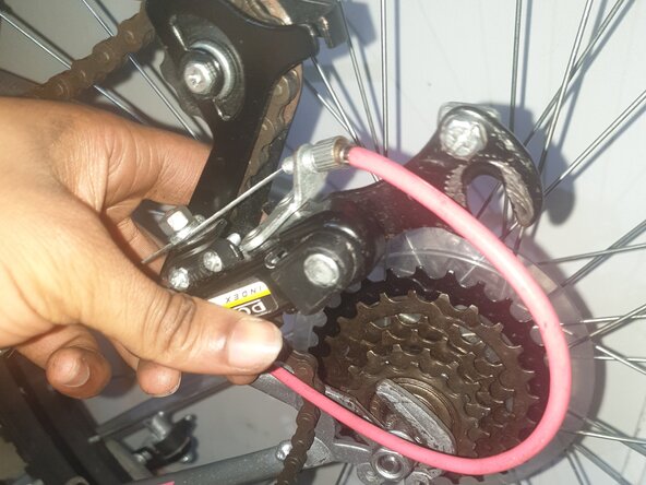

    • Pull the tension wire to maximum tension (as far back as it will let you) and then tighten the bolt with wrench while maintaining that tension

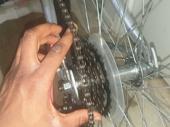

    • Get the chain back on the biggest chainring/sprocket in the rear crankset.
