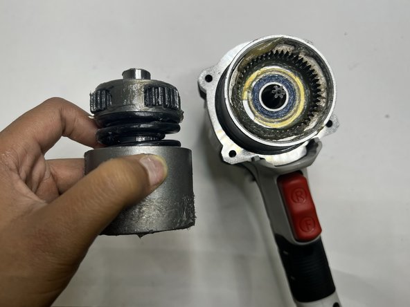

      • Using the Hex Security SAE 7/32", remove the four 10 mm socket screws at the base of the gearcase.
    2. Porter-Cable PCE211 Fan Replacement: crwdns2935265:02crwdnd2935265:01crwdnd2935265:03crwdne2935265:0 Porter-Cable PCE211 Fan Replacement: crwdns2935265:02crwdnd2935265:02crwdnd2935265:03crwdne2935265:0 Porter-Cable PCE211 Fan Replacement: crwdns2935265:02crwdnd2935265:03crwdnd2935265:03crwdne2935265:0
      • Grip the body of the impact wrench with one hand and the gearcase in the other and firmly pull to remove it.
      • Be careful about any loose parts when removing the head.
    1. Porter-Cable PCE211 Fan Replacement, Anvil: crwdns2935265:03crwdnd2935265:01crwdnd2935265:03crwdne2935265:0 Porter-Cable PCE211 Fan Replacement, Anvil: crwdns2935265:03crwdnd2935265:02crwdnd2935265:03crwdne2935265:0 Porter-Cable PCE211 Fan Replacement, Anvil: crwdns2935265:03crwdnd2935265:03crwdnd2935265:03crwdne2935265:0
      • Firmly pull the to remove drill bit holder also known as the anvil.
      • Before replacing the anvil, lubricate the base for the best performance.
    1. Porter-Cable PCE211 Fan Replacement, Motor: crwdns2935265:04crwdnd2935265:01crwdnd2935265:03crwdne2935265:0 Porter-Cable PCE211 Fan Replacement, Motor: crwdns2935265:04crwdnd2935265:02crwdnd2935265:03crwdne2935265:0 Porter-Cable PCE211 Fan Replacement, Motor: crwdns2935265:04crwdnd2935265:03crwdnd2935265:03crwdne2935265:0
      • This section tends to get messy so it would be best to have a paper towel or microfiber towel handy.
      • Pull the motor out with your hands.

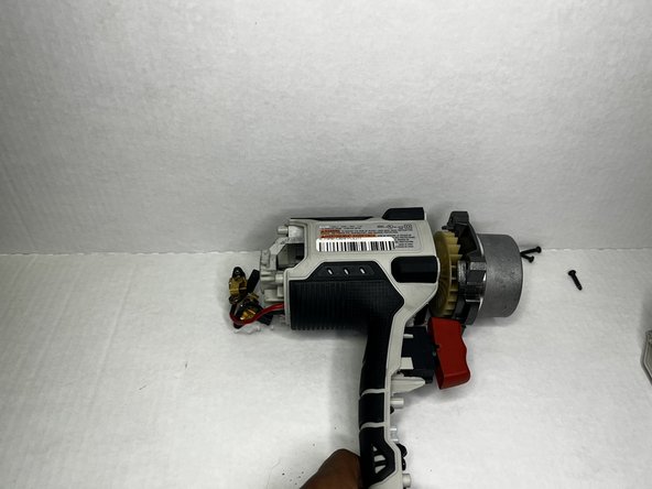

    1. Porter-Cable PCE211 Fan Replacement, Grip: crwdns2935265:08crwdnd2935265:01crwdnd2935265:02crwdne2935265:0 Porter-Cable PCE211 Fan Replacement, Grip: crwdns2935265:08crwdnd2935265:02crwdnd2935265:02crwdne2935265:0
      • Using the Phillips #2 screwdriver, remove the three 8 mm screws from the grip of the impact wrench.
    2. Porter-Cable PCE211 Fan Replacement: crwdns2935265:09crwdnd2935265:01crwdnd2935265:02crwdne2935265:0 Porter-Cable PCE211 Fan Replacement: crwdns2935265:09crwdnd2935265:02crwdnd2935265:02crwdne2935265:0
      • Pull the grip from the body of the impact wrench.
    1. Porter-Cable PCE211 Fan Replacement, Fan: crwdns2935265:010crwdnd2935265:01crwdnd2935265:02crwdne2935265:0 Porter-Cable PCE211 Fan Replacement, Fan: crwdns2935265:010crwdnd2935265:02crwdnd2935265:02crwdne2935265:0
      • Lift the hammer block (which is attached to the fan) out of the case.
      • It is a little heavy so be careful when lifting it out.
    2. Porter-Cable PCE211 Fan Replacement: crwdns2935265:011crwdnd2935265:01crwdnd2935265:02crwdne2935265:0 Porter-Cable PCE211 Fan Replacement: crwdns2935265:011crwdnd2935265:02crwdnd2935265:02crwdne2935265:0
      • If you're doing maintenance and the fan isn't damage, use a microfiber cloth to clean the fan.
      • Wipe well until there's no residue or oil lubricant.
