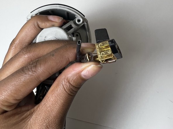

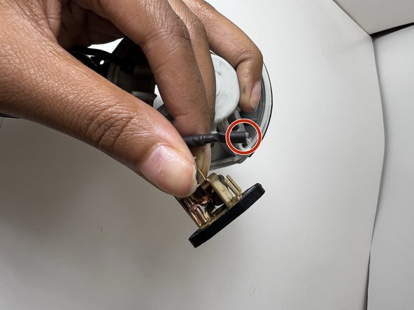

    1. Porter-Cable PCE211 Brush Replacement, Brush: crwdns2935265:03crwdnd2935265:01crwdnd2935265:02crwdne2935265:0 Porter-Cable PCE211 Brush Replacement, Brush: crwdns2935265:03crwdnd2935265:02crwdnd2935265:02crwdne2935265:0
      • Remove the brushes connected to the red and black cords.
      • They are not secured so they made drop out naturally.
    2. Porter-Cable PCE211 Brush Replacement: crwdns2935265:04crwdnd2935265:01crwdnd2935265:03crwdne2935265:0 Porter-Cable PCE211 Brush Replacement: crwdns2935265:04crwdnd2935265:02crwdnd2935265:03crwdne2935265:0 Porter-Cable PCE211 Brush Replacement: crwdns2935265:04crwdnd2935265:03crwdnd2935265:03crwdne2935265:0
      • Gently pull each brush off the corresponding cable to avoid damaging the cables.
