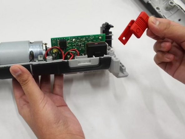

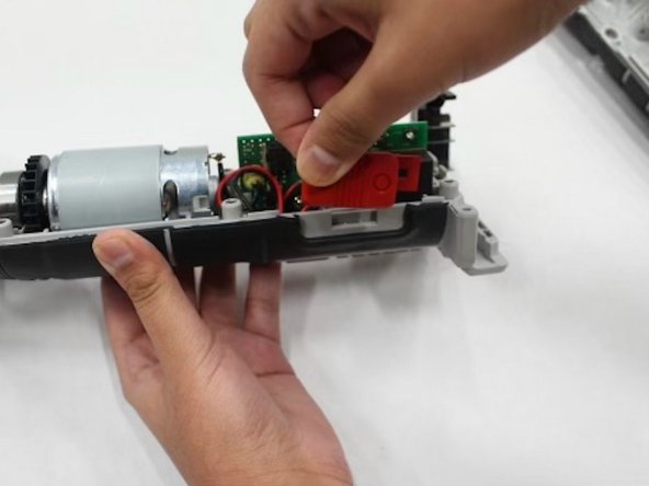

    • Lift the case off to access the internals of the tool.
  7. Porter-Cable PCC710B Switch Actuator Replacement, Switch Actuator: crwdns2935265:07crwdnd2935265:01crwdnd2935265:03crwdne2935265:0 Porter-Cable PCC710B Switch Actuator Replacement, Switch Actuator: crwdns2935265:07crwdnd2935265:02crwdnd2935265:03crwdne2935265:0 Porter-Cable PCC710B Switch Actuator Replacement, Switch Actuator: crwdns2935265:07crwdnd2935265:03crwdnd2935265:03crwdne2935265:0
    • Gently remove the red switch actuator from the housing.
