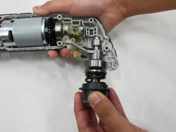

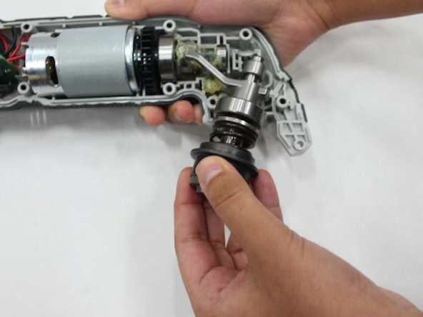

  7. Porter-Cable PCC710B Spindle Assembly Replacement, Spindle assembly: crwdns2935265:07crwdnd2935265:01crwdnd2935265:03crwdne2935265:0 Porter-Cable PCC710B Spindle Assembly Replacement, Spindle assembly: crwdns2935265:07crwdnd2935265:02crwdnd2935265:03crwdne2935265:0 Porter-Cable PCC710B Spindle Assembly Replacement, Spindle assembly: crwdns2935265:07crwdnd2935265:03crwdnd2935265:03crwdne2935265:0
    • The outstretched arms of the spindle will be covered in grease - so grab a napkin to keep your hands clean!
    • Grasp the bottom of the spindle and pull it out towards you.
    • The spindle should come out easily. If not, lightly twist the object left and right while pulling it out.
    • You must grease the new spindle's arms before the install or else these parts will overheat and break. In addition, you'll have to maneuver the arms of the spindle around the head of the eccentric shaft. Finally, apply a light force to snap the spindle into place.
