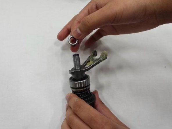

  8. Porter-Cable PCC710B Needle Bearing Replacement, Needle bearing: crwdns2935265:08crwdnd2935265:01crwdnd2935265:03crwdne2935265:0 Porter-Cable PCC710B Needle Bearing Replacement, Needle bearing: crwdns2935265:08crwdnd2935265:02crwdnd2935265:03crwdne2935265:0 Porter-Cable PCC710B Needle Bearing Replacement, Needle bearing: crwdns2935265:08crwdnd2935265:03crwdnd2935265:03crwdne2935265:0
    • Using your hands, remove the silver ring-shaped needle bearing sitting on top of the spindle assembly.
    • When replacing, simply place the new needle bearing on the spindle assembly shaft.
