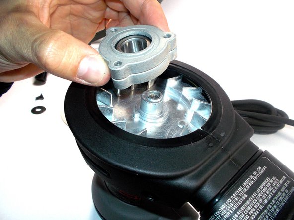

  5. Porter-Cable 382 Fan Replacement, Fan: crwdns2935265:05crwdnd2935265:01crwdnd2935265:02crwdne2935265:0 Porter-Cable 382 Fan Replacement, Fan: crwdns2935265:05crwdnd2935265:02crwdnd2935265:02crwdne2935265:0
    • Once the dust brake/ seal is removed locate the screw in the center of the device holding down the bearing and fan assembly.
    • unscrew this bolt using a T20 star bit and carefully remove the washer and bearing as shown.

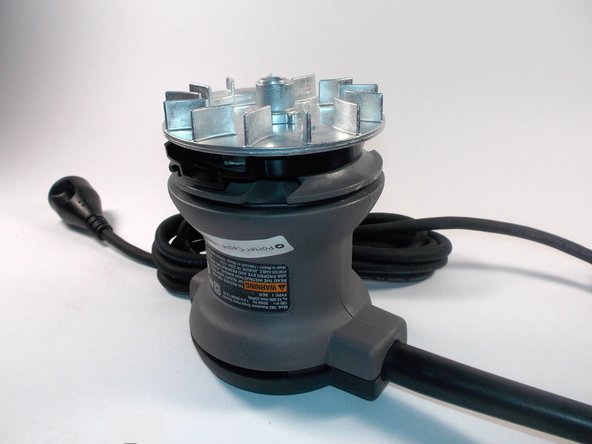

  9. Porter-Cable 382 Fan Replacement: crwdns2935265:09crwdnd2935265:01crwdnd2935265:01crwdne2935265:0
    • The fan can then simply be pulled from its axle and be replaced with the fan blades facing up.
