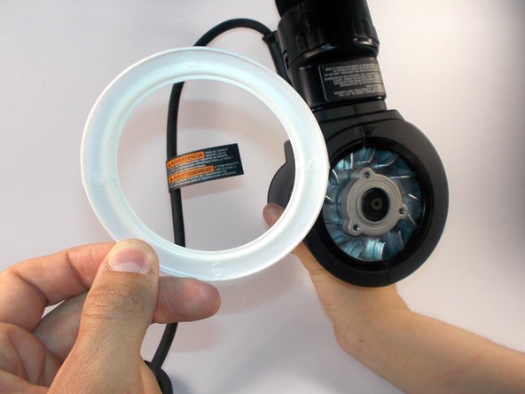

    • When changing the sander pad, be sure to rotate the sander upside down so the pad and three highlighted screws are facing upward toward you.
    • Once the sander is upside down begin by removing your old sandpaper.
    • Once the sandpaper is removed locate the three screws on your sander pad.
  2. Porter-Cable 382 Dust Seal | Dust Break Replacement: crwdns2935265:02crwdnd2935265:01crwdnd2935265:01crwdne2935265:0
    • Remove the three, (star bolt) screws with the iFixit screw driver with a "T20" head. Be sure to hold the pad of the sander as it will rotate as you try to loosen the screws.
    • Once the screws are removed pull upward toward you and the sander pad will come apart from the device.
  3. Porter-Cable 382 Dust Seal | Dust Break Replacement, Dust Seal/ Break: crwdns2935265:03crwdnd2935265:01crwdnd2935265:01crwdne2935265:0
    • Once the sander pad is removed and the sander is exposed locate the white plastic like circular piece surrounding the outside of the sander.
  4. Porter-Cable 382 Dust Seal | Dust Break Replacement: crwdns2935265:04crwdnd2935265:01crwdnd2935265:02crwdne2935265:0 Porter-Cable 382 Dust Seal | Dust Break Replacement: crwdns2935265:04crwdnd2935265:02crwdnd2935265:02crwdne2935265:0
    • Once you have located the plastic white ring pull up its outer edge as shown. The lip on the inside will bend and be freed from its secured placement.
    • To reassemble, you will have to line up the protruding square with the key slot as shown otherwise your dust seal/ brake will not go back in.
