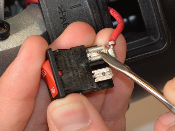

    • Find the wire plugs which are attached to the power switch. These connections are located at the back of the plastic box that houses the switch.
    • Use the spudger to carefully loosen the metal and rubber coverings, and detach the connections from the switch.
    • While some force is needed in order to successfully pull the connections free, have care in making sure that you don’t damage any of the metal components. If needed you may carefully use a metal spudger instead of a plastic opening tool.

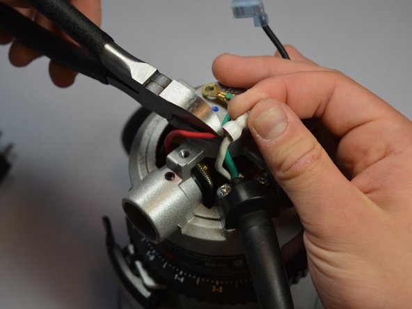

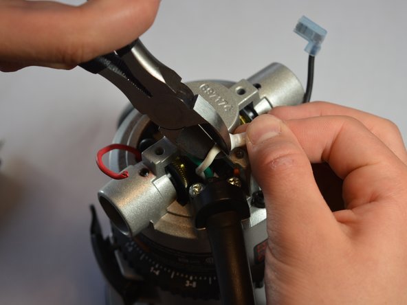

    • Use a pair of pliers to cut the white and red wires where they are crimped and the white wire connector.
    • Reminder: When following the guide in reverse order, you will need to remove a small section of the rubber insulation to reveal the wire. The wires will then have to be twisted together and covered with a new plastic housing. This process will shorten the wires every time the power cord is replaced.

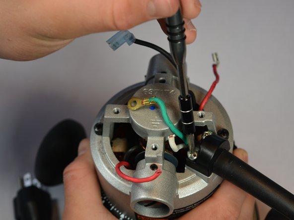

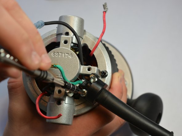

    • Locate the two 20 mm screws on the base of the power cord.
    • Use a pentalobe screwdriver to unscrew the screws.

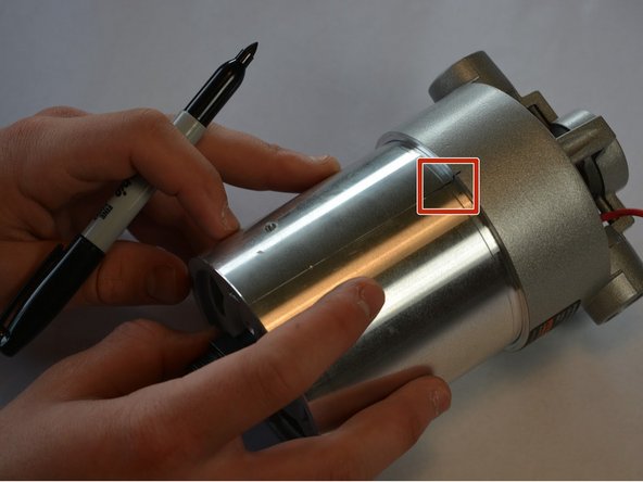

    • Use a sharpie to mark where the base and the cap meet. This will allow you to make sure that you have all the alignment correct during reassembly.

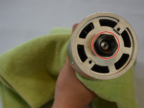

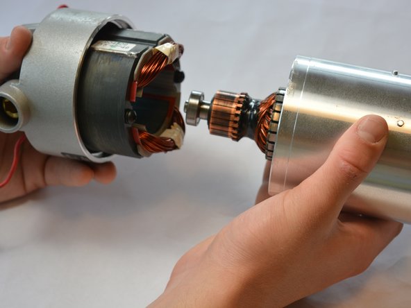

    • With a rag in hand, hold the back of the motor tightly.

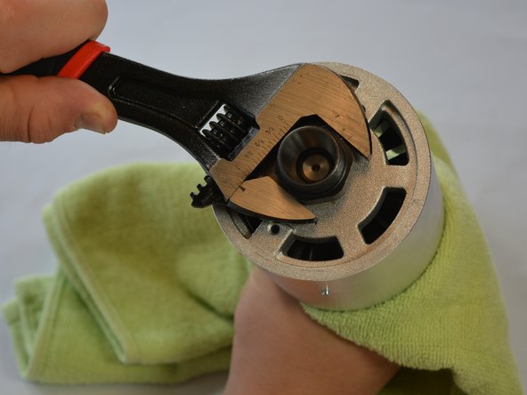

    • Locate the black hexagon chuck at the bottom of the router
    • Using a wrench, unscrew the chuck. The motor and the chuck will pull free from opposite ends of the base and can be replaced at your leisure.
    • Depending on how tight the chuck is fastened, an impact screw gun may be required.
