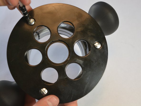

    1. Porter Cable 690LR Base Panel Replacement, Base Panel: crwdns2935265:03crwdnd2935265:01crwdnd2935265:02crwdne2935265:0 Porter Cable 690LR Base Panel Replacement, Base Panel: crwdns2935265:03crwdnd2935265:02crwdnd2935265:02crwdne2935265:0
      • Orient the base so the black circular plate is facing you. Locate the three silver screw heads.
      • Use a flathead screwdriver to take off the three 10 mm screws.
