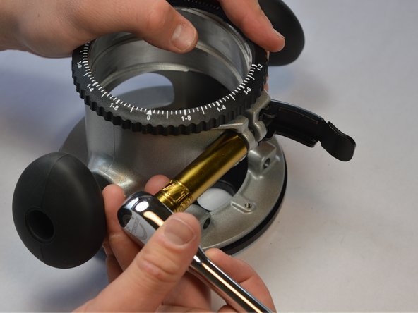

  3. Porter Cable 690LR Base Latch Replacement, Base Latch: crwdns2935265:03crwdnd2935265:01crwdnd2935265:02crwdne2935265:0 Porter Cable 690LR Base Latch Replacement, Base Latch: crwdns2935265:03crwdnd2935265:02crwdnd2935265:02crwdne2935265:0
    • Locate the 30 mm bolt and nut attaching the latch to the base.
    • Use a wrench to remove the nut attached to the bolt, freeing the latch from the base.
