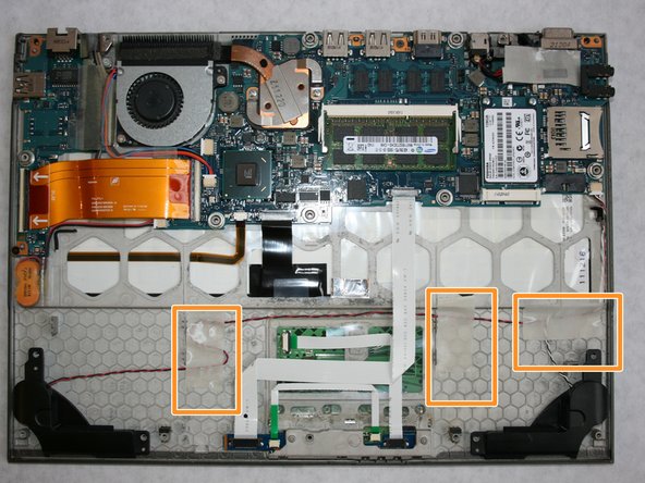

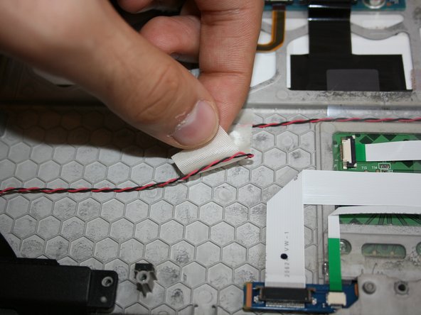

  7. Portege Z830-S8302 Speaker Replacement, Speaker: crwdns2935265:07crwdnd2935265:01crwdnd2935265:03crwdne2935265:0 Portege Z830-S8302 Speaker Replacement, Speaker: crwdns2935265:07crwdnd2935265:02crwdnd2935265:03crwdne2935265:0 Portege Z830-S8302 Speaker Replacement, Speaker: crwdns2935265:07crwdnd2935265:03crwdnd2935265:03crwdne2935265:0
    • There are two black speakers on either side of the bottom corner of the device.
    • Remove tape securing speaker wires to frame.

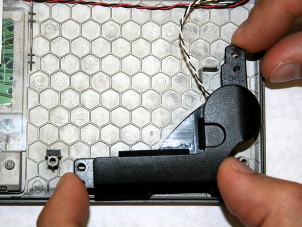

    • With the plug disconnected, now you can remove the speakers.
    • Lift the speakers up vertically removing them from pegs that hold them in place.
    • This does not require a tool as they are not fastened down, just lift and remove.
