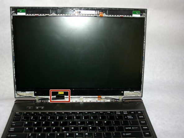

    • Use a plastic opening tool to gently pry plastic frame from screen. Detach all housing clips around the perimeter of the screen.
  2. Portege Z830-S8302 Screen Replacement: crwdns2935265:02crwdnd2935265:01crwdnd2935265:02crwdne2935265:0 Portege Z830-S8302 Screen Replacement: crwdns2935265:02crwdnd2935265:02crwdnd2935265:02crwdne2935265:0
    • Remove two 3mm screws with a Phillips #000 screwdriver.
  3. Portege Z830-S8302 Screen Replacement: crwdns2935265:03crwdnd2935265:01crwdnd2935265:02crwdne2935265:0 Portege Z830-S8302 Screen Replacement: crwdns2935265:03crwdnd2935265:02crwdnd2935265:02crwdne2935265:0
    • Wedge a blue plastic opening tool between the screen and the frame to free the screen.
    • Do not fully remove screen as it is still attached by connector cable on bottom
  4. Portege Z830-S8302 Screen Replacement: crwdns2935265:04crwdnd2935265:01crwdnd2935265:02crwdne2935265:0 Portege Z830-S8302 Screen Replacement: crwdns2935265:04crwdnd2935265:02crwdnd2935265:02crwdne2935265:0
    • Disconnect the display cable with your fingers to fully remove the screen from the device.
