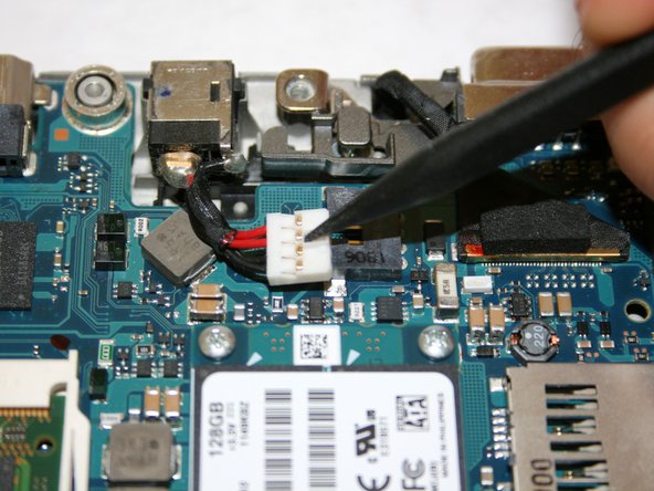

  6. Portege Z830-S8302 Motherboard Replacement: crwdns2935265:06crwdnd2935265:01crwdnd2935265:03crwdne2935265:0 Portege Z830-S8302 Motherboard Replacement: crwdns2935265:06crwdnd2935265:02crwdnd2935265:03crwdne2935265:0 Portege Z830-S8302 Motherboard Replacement: crwdns2935265:06crwdnd2935265:03crwdnd2935265:03crwdne2935265:0
    • Using the nylon spudger, disconnect the white plugin.
    • Once the wire has been disconnected you may remove the battery.

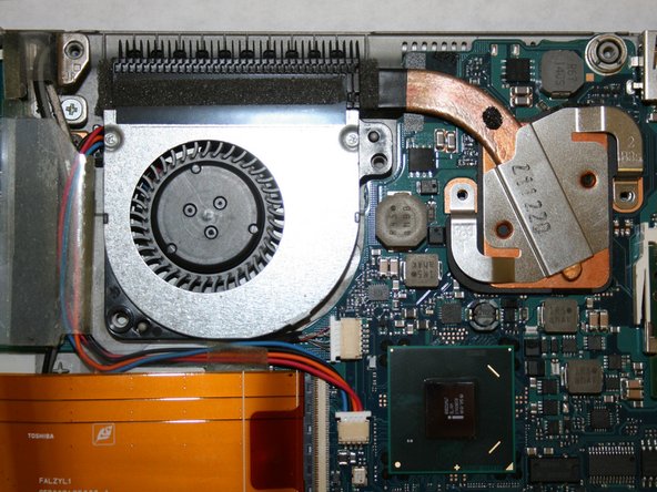

    • Use a Phillips #0 screwdriver to remove the two 5 mm screws securing the fan.
  8. Portege Z830-S8302 Motherboard Replacement: crwdns2935265:08crwdnd2935265:01crwdnd2935265:02crwdne2935265:0 Portege Z830-S8302 Motherboard Replacement: crwdns2935265:08crwdnd2935265:02crwdnd2935265:02crwdne2935265:0

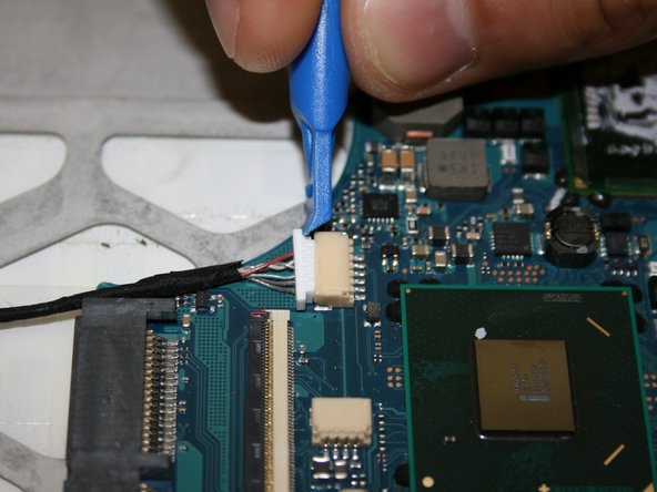

    • Use a nylon spudger to push the wire (red/blue) plug out of its motherboard port.
    • Be gentle and avoid applying extensive pressure when removing this plug, as the motherboard is fragile.

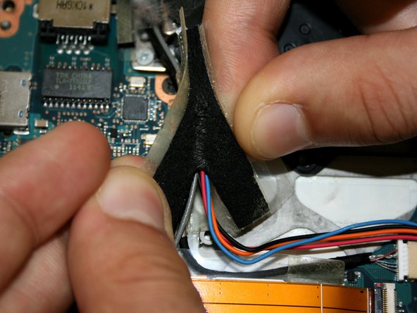

  9. Portege Z830-S8302 Motherboard Replacement: crwdns2935265:09crwdnd2935265:01crwdnd2935265:02crwdne2935265:0 Portege Z830-S8302 Motherboard Replacement: crwdns2935265:09crwdnd2935265:02crwdnd2935265:02crwdne2935265:0
    • Lift up the wire and peel back the clear protective tape.
    • Split the black protective foam inside the tape in half to uncover the wires.
    • This step should free the wires free from their connections.
  10. Portege Z830-S8302 Motherboard Replacement: crwdns2935265:010crwdnd2935265:01crwdnd2935265:02crwdne2935265:0 Portege Z830-S8302 Motherboard Replacement: crwdns2935265:010crwdnd2935265:02crwdnd2935265:02crwdne2935265:0
    • Remove the fan from the motherboard.

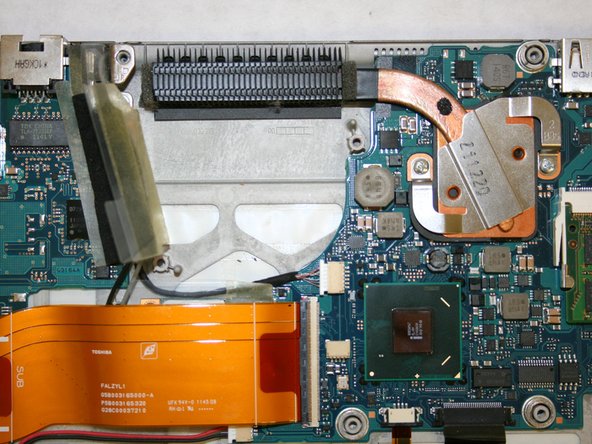

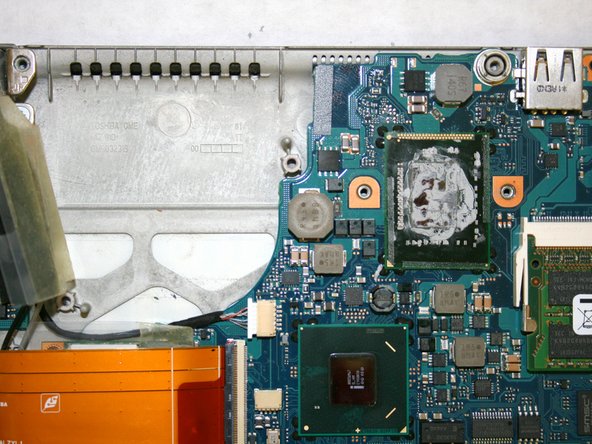

  11. Portege Z830-S8302 Motherboard Replacement: crwdns2935265:011crwdnd2935265:01crwdnd2935265:03crwdne2935265:0 Portege Z830-S8302 Motherboard Replacement: crwdns2935265:011crwdnd2935265:02crwdnd2935265:03crwdne2935265:0 Portege Z830-S8302 Motherboard Replacement: crwdns2935265:011crwdnd2935265:03crwdnd2935265:03crwdne2935265:0

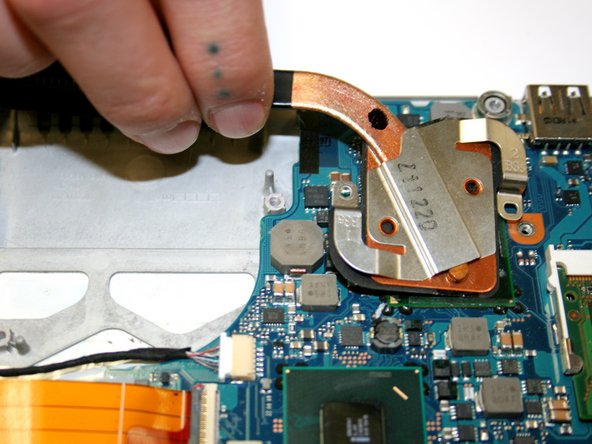

    • Remove the two 4 mm screws from the heat sink with a Phillips #0 screwdriver.
    • Lift and remove the heat sink from the CPU.
    • Reapply thermal paste to the heat sink upon reassembly.

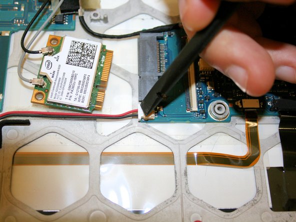

  12. Portege Z830-S8302 Motherboard Replacement: crwdns2935265:012crwdnd2935265:01crwdnd2935265:03crwdne2935265:0 Portege Z830-S8302 Motherboard Replacement: crwdns2935265:012crwdnd2935265:02crwdnd2935265:03crwdne2935265:0 Portege Z830-S8302 Motherboard Replacement: crwdns2935265:012crwdnd2935265:03crwdnd2935265:03crwdne2935265:0
    • Use a plastic opening tool to flip up the black lock-bar on the ZIF connector, then disconnect the large orange ribbon cable.

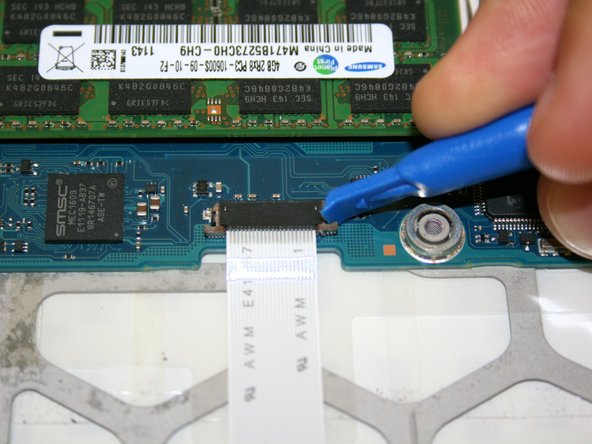

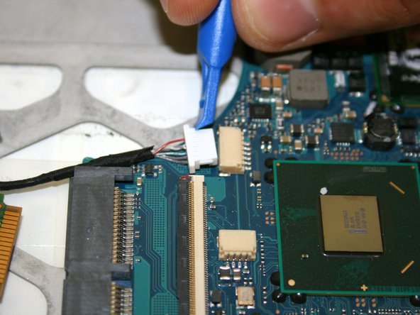

    • Disconnect the plug from the motherboard using a Plastic Opening Tool.

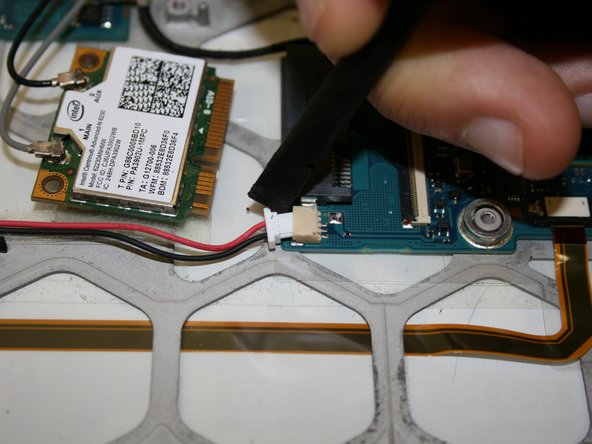

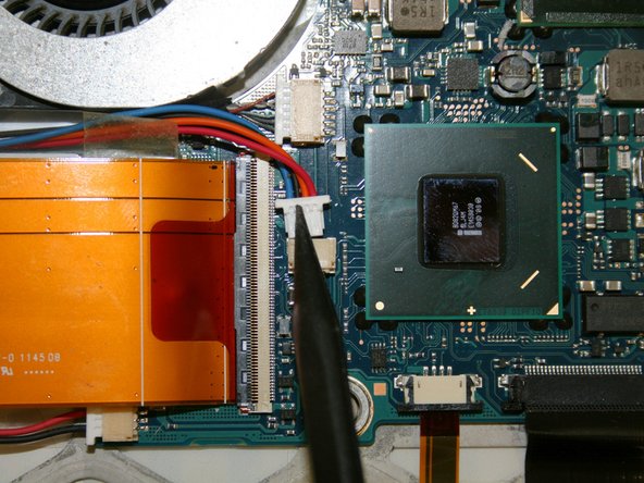

    • Remove the CMOS battery connector cable (red/black) from its port using a Nylon Spudger Tool.

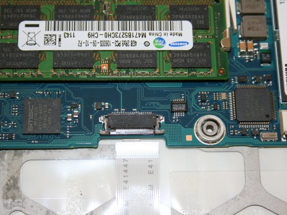

    • Disconnect the cable from the motherboard using a Nylon Spudger.

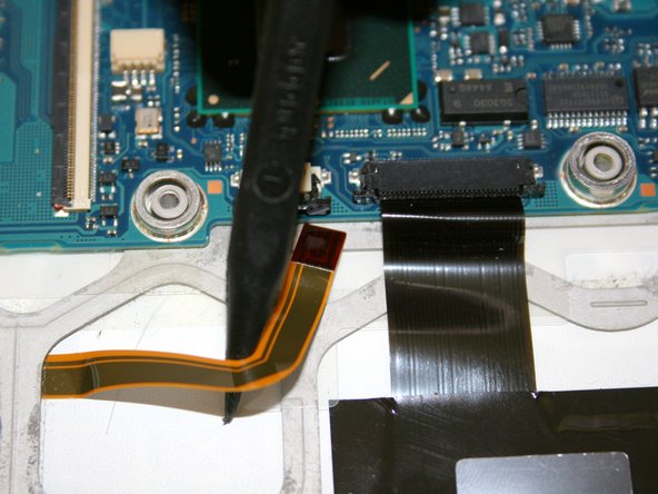

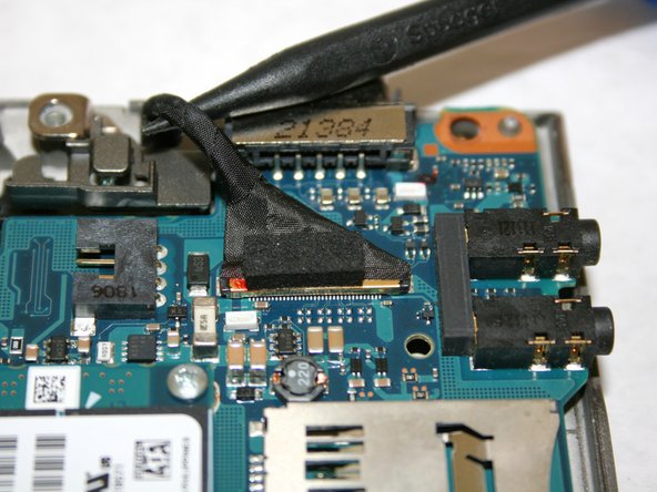

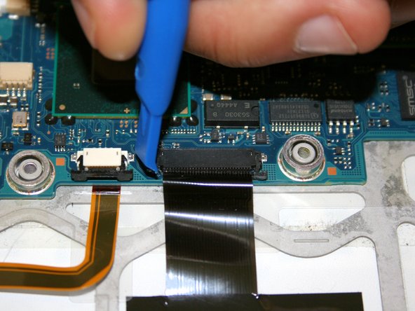

  18. Portege Z830-S8302 Motherboard Replacement: crwdns2935265:018crwdnd2935265:01crwdnd2935265:03crwdne2935265:0 Portege Z830-S8302 Motherboard Replacement: crwdns2935265:018crwdnd2935265:02crwdnd2935265:03crwdne2935265:0 Portege Z830-S8302 Motherboard Replacement: crwdns2935265:018crwdnd2935265:03crwdnd2935265:03crwdne2935265:0

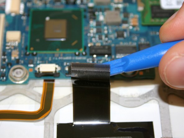

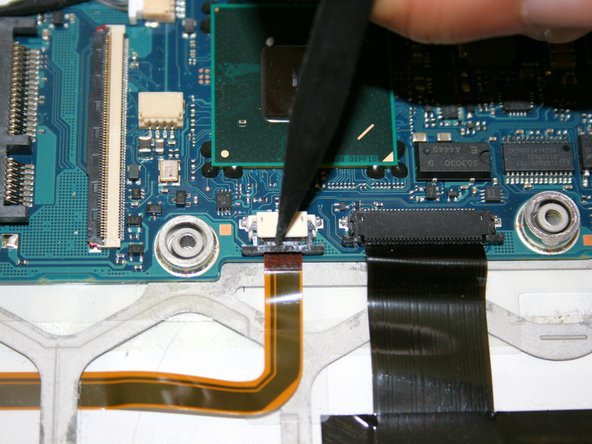

    • Use a Plastic Opening Tool to disconnect the black ribbon from the motherboard.

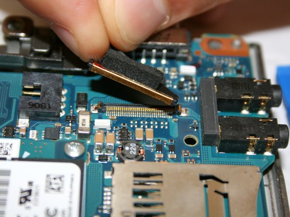

    • Remove the screen data cable from its connector.

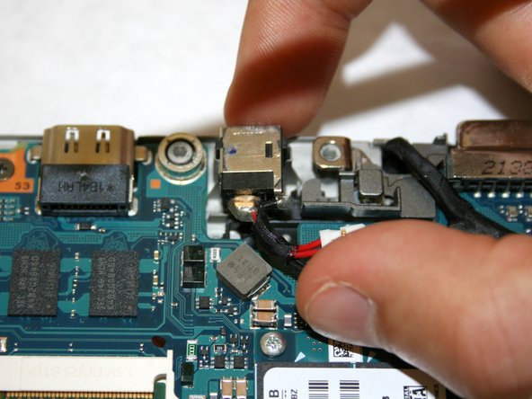

  21. Portege Z830-S8302 Motherboard Replacement: crwdns2935265:021crwdnd2935265:01crwdnd2935265:03crwdne2935265:0 Portege Z830-S8302 Motherboard Replacement: crwdns2935265:021crwdnd2935265:02crwdnd2935265:03crwdne2935265:0 Portege Z830-S8302 Motherboard Replacement: crwdns2935265:021crwdnd2935265:03crwdnd2935265:03crwdne2935265:0
    • Disconnect the DC power plug connector located at the top of the motherboard using a nylon spudger.
    • Gently remove the whole piece from its holder and place it aside.

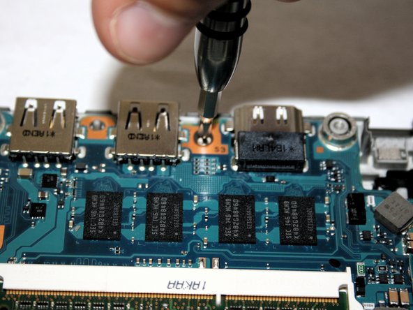

  22. Portege Z830-S8302 Motherboard Replacement: crwdns2935265:022crwdnd2935265:01crwdnd2935265:03crwdne2935265:0 Portege Z830-S8302 Motherboard Replacement: crwdns2935265:022crwdnd2935265:02crwdnd2935265:03crwdne2935265:0 Portege Z830-S8302 Motherboard Replacement: crwdns2935265:022crwdnd2935265:03crwdnd2935265:03crwdne2935265:0
    • Remove one Phillips #0 3 mm screw from the top of the motherboard.
    • Gently lift the motherboard out of its casing to fully remove it from the device.
