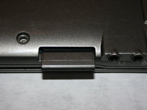

  3. Portege Z830-S8302 Internal Cooling Fan Replacement: crwdns2935265:03crwdnd2935265:01crwdnd2935265:03crwdne2935265:0 Portege Z830-S8302 Internal Cooling Fan Replacement: crwdns2935265:03crwdnd2935265:02crwdnd2935265:03crwdne2935265:0 Portege Z830-S8302 Internal Cooling Fan Replacement: crwdns2935265:03crwdnd2935265:03crwdnd2935265:03crwdne2935265:0

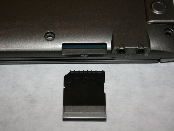

    • Remove the SD card in top right hand corner of the device, next to the headphone ports.
    • Push in the SD card then pull out completely to remove from slot.
    • This will help in the removal of backplate.

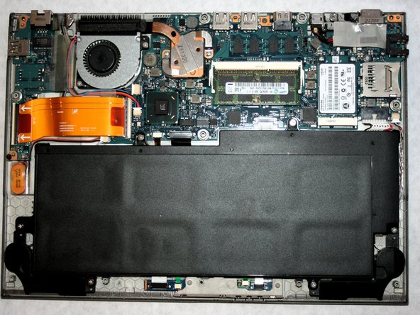

    • Lift the back plate starting at the opposing edge to the SD card. Lift from left to right and continue lifting this plate at this angle until its free from the laptop.
    • Once the backplate is completely off, this will reveal the inside components of the device.

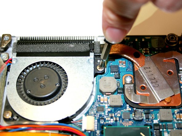

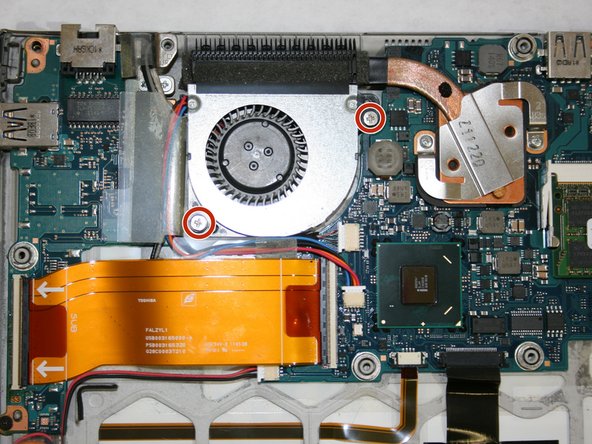

    • Remove two 5mm Phillips #0 screws from the fan housing.

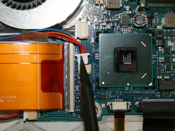

  6. Portege Z830-S8302 Internal Cooling Fan Replacement: crwdns2935265:06crwdnd2935265:01crwdnd2935265:02crwdne2935265:0 Portege Z830-S8302 Internal Cooling Fan Replacement: crwdns2935265:06crwdnd2935265:02crwdnd2935265:02crwdne2935265:0
    • Use the nylon spudger to disconnect the wire (red/blue) plug from the motherboard.
    • Be gentle and do not apply too much pressure when removing the plug as the motherboard may be fragile.

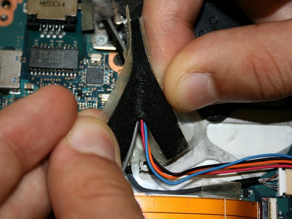

    • Lift up the wire and peel back the clear protective tape.
    • Split the black protective foam inside the tape in half to uncover the wires.
    • This should make the wires free of all connections.

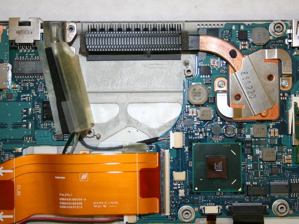

  8. Portege Z830-S8302 Internal Cooling Fan Replacement: crwdns2935265:08crwdnd2935265:01crwdnd2935265:02crwdne2935265:0 Portege Z830-S8302 Internal Cooling Fan Replacement: crwdns2935265:08crwdnd2935265:02crwdnd2935265:02crwdne2935265:0
    • The fan is now free and able to be removed. Lift the fan out of place.
