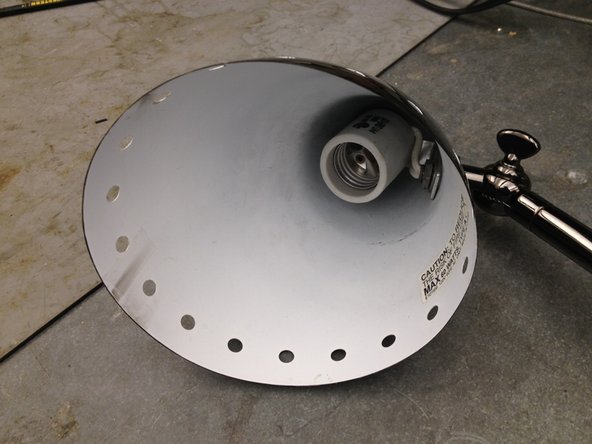

    • The attached picture displays the lamp before the teardown.

    • Place the lamp gently on its side on a flat surface
    • Twist the lightbulb counter-clockwise to remove it from the lamp's head.
    • After lightbulb removal, the component attaching the lightbulb and lamp's head is exposed.

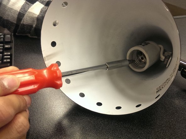

  4. Portable Luminaries Lamp Teardown: crwdns2935265:04crwdnd2935265:01crwdnd2935265:02crwdne2935265:0 Portable Luminaries Lamp Teardown: crwdns2935265:04crwdnd2935265:02crwdnd2935265:02crwdne2935265:0
    • Next, the light bulb housing can be detached from the lamp head
    • Using the Philips screw driver, unscrew the two 5mm diameter screws within the light bulb housing

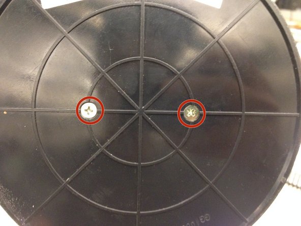

  5. Portable Luminaries Lamp Teardown: crwdns2935265:05crwdnd2935265:01crwdnd2935265:02crwdne2935265:0 Portable Luminaries Lamp Teardown: crwdns2935265:05crwdnd2935265:02crwdnd2935265:02crwdne2935265:0
    • Keep the lamp on its side
    • The bottom is now exposed and two screws are visible
    • Using the Philips Screwdriver, unscrew the two 7mm gold screws from the bottom of the base

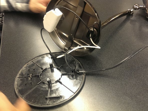

  6. Portable Luminaries Lamp Teardown: crwdns2935265:06crwdnd2935265:01crwdnd2935265:02crwdne2935265:0 Portable Luminaries Lamp Teardown: crwdns2935265:06crwdnd2935265:02crwdnd2935265:02crwdne2935265:0
    • Once the screws attached to the base are removed, the base's bottom lid detaches from the lamp.
    • Within the base resides two components: the lamp's weight and the switch.
    • The weight sits on the bottom base lid, so it separates without the use of additional tools.
  7. Portable Luminaries Lamp Teardown: crwdns2935265:07crwdnd2935265:01crwdnd2935265:01crwdne2935265:0
    • The white container holding the switch does not need tools for opening.
    • The switch container is clipped shut and opens by unlatching the tab
