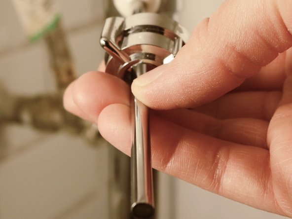

    • Place bucket directly under the sink below the pop-up assembly. Excess water may leak
    • The pivot rod that is inserted within a hole in the pop-up extension bar. Move the pop-up extension bar away from the pivot rod.

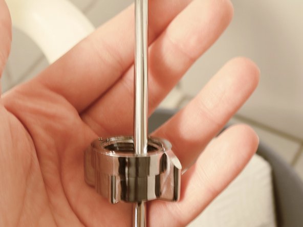

  2. Pop-Up Assembly Stopper Piece Replacement: crwdns2935265:02crwdnd2935265:01crwdnd2935265:01crwdne2935265:0
    • Disconnect the pivot rod from the center pop-up extension.

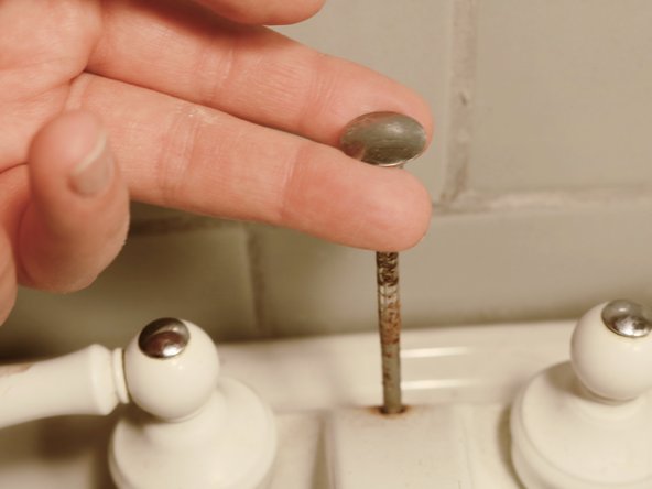

  3. Pop-Up Assembly Stopper Piece Replacement: crwdns2935265:03crwdnd2935265:01crwdnd2935265:02crwdne2935265:0 Pop-Up Assembly Stopper Piece Replacement: crwdns2935265:03crwdnd2935265:02crwdnd2935265:02crwdne2935265:0
    • Lift up the center pop-up rod on the faucet until it is detached. The extension rod will pull up with it.
  4. Pop-Up Assembly Stopper Piece Replacement: crwdns2935265:04crwdnd2935265:01crwdnd2935265:03crwdne2935265:0 Pop-Up Assembly Stopper Piece Replacement: crwdns2935265:04crwdnd2935265:02crwdnd2935265:03crwdne2935265:0 Pop-Up Assembly Stopper Piece Replacement: crwdns2935265:04crwdnd2935265:03crwdnd2935265:03crwdne2935265:0
    • Below the sink is the pivot nut. Turn the pivot nut counterclockwise until it is completely loose and remove from the pivot rod.

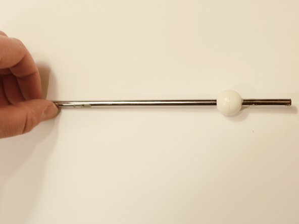

  5. Pop-Up Assembly Stopper Piece Replacement: crwdns2935265:05crwdnd2935265:01crwdnd2935265:02crwdne2935265:0 Pop-Up Assembly Stopper Piece Replacement: crwdns2935265:05crwdnd2935265:02crwdnd2935265:02crwdne2935265:0
    • Pull the pivot rod out to expose the ball. Remove the whole pivot rod fixture.
