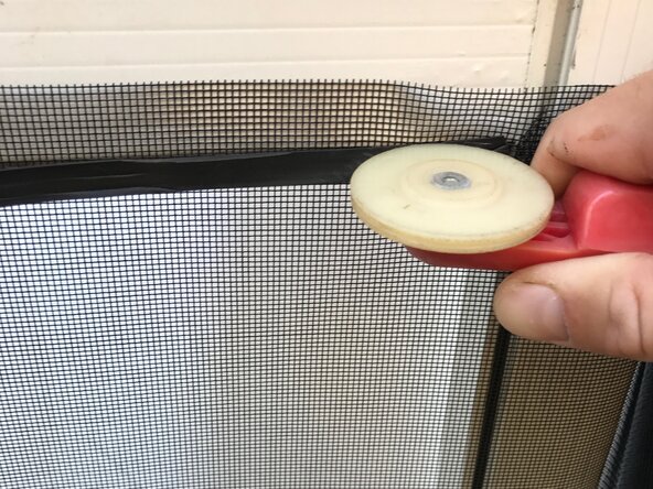

    5. Pool Screen Replacement, Placing the thread and screen: crwdns2935265:05crwdnd2935265:01crwdnd2935265:02crwdne2935265:0 Pool Screen Replacement, Placing the thread and screen: crwdns2935265:05crwdnd2935265:02crwdnd2935265:02crwdne2935265:0
      • Pull the new screen thread from corner to corner, along the crease of the pool cage. Cut any excess thread from the corners.
      • Use a screen roller to press the thread and the screen underneath against the pool cage crease to secure them. It helps to pull the thread and screen tight while rolling over it.
      • The roller pictured is available at any home improvement store. It will be located next to the pool screens and thread.
