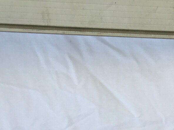

  1. Pool Screen Replacement, Damaged screen area: crwdns2935265:01crwdnd2935265:01crwdnd2935265:01crwdne2935265:0
    • Locate the damaged area on your screen. Use this area to remove the rest of the screen. Using an area that is already damaged makes it easier to remove the old screen.

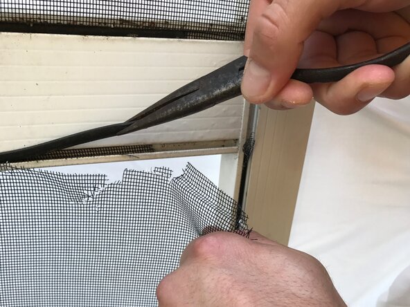

  2. Pool Screen Replacement, Removing the screen and thread: crwdns2935265:02crwdnd2935265:01crwdnd2935265:02crwdne2935265:0 Pool Screen Replacement, Removing the screen and thread: crwdns2935265:02crwdnd2935265:02crwdnd2935265:02crwdne2935265:0
    • Use needle nose pliers to pull the rubber screen thread from the pool cage crease.
    • To help remove the damaged screen, pull down on the screen while you are removing the thread of the old screen.

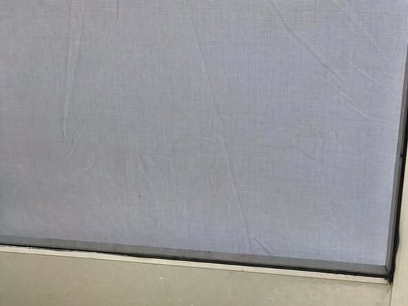

  3. Pool Screen Replacement, Checking for leftover thread: crwdns2935265:03crwdnd2935265:01crwdnd2935265:01crwdne2935265:0
    • Examine your work. It should match the image as shown.
    • There should be no thread left in the crease of the pool cage. Remove any remaining screen thread with the needle nose pliers.

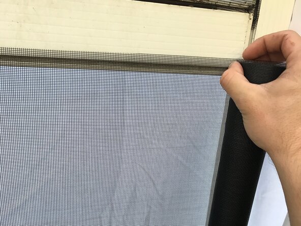

  4. Pool Screen Replacement, Measuring the screen: crwdns2935265:04crwdnd2935265:01crwdnd2935265:01crwdne2935265:0
    • Measure the area of the pool cage that needs to be replaced with a new roll of screen. Cut out the needed amount of screen from the new roll.
    • Do not cut the excess screen on the sides of the pool cage; it will be done in a later step.

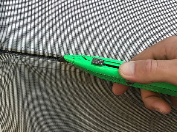

  6. Pool Screen Replacement, Removing extra screen: crwdns2935265:06crwdnd2935265:01crwdnd2935265:01crwdne2935265:0
    • Cut the excess screen from the top, bottom, and sides of the pool cage.
    • Be careful when using the box cutter. Always cut away from your body in order to avoid injury.

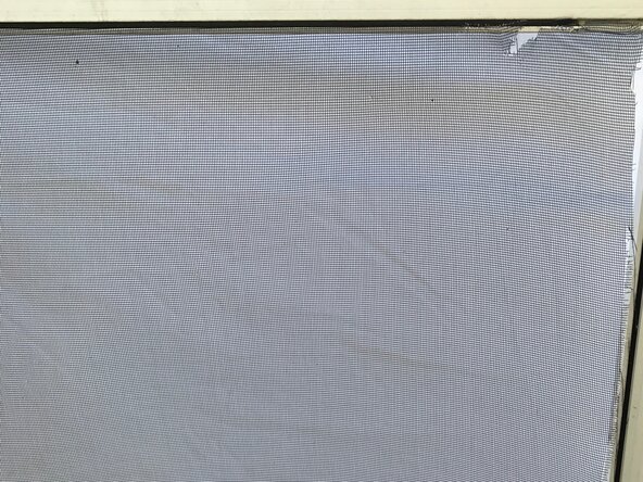

  7. Pool Screen Replacement, Finishing up: crwdns2935265:07crwdnd2935265:01crwdnd2935265:02crwdne2935265:0 Pool Screen Replacement, Finishing up: crwdns2935265:07crwdnd2935265:02crwdnd2935265:02crwdne2935265:0
    • Check the pool cage for any problems with the newly attached screen. The new thread should be pressed firmly into the pool cage, and the screen should be pulled tight so there are no wrinkles.
