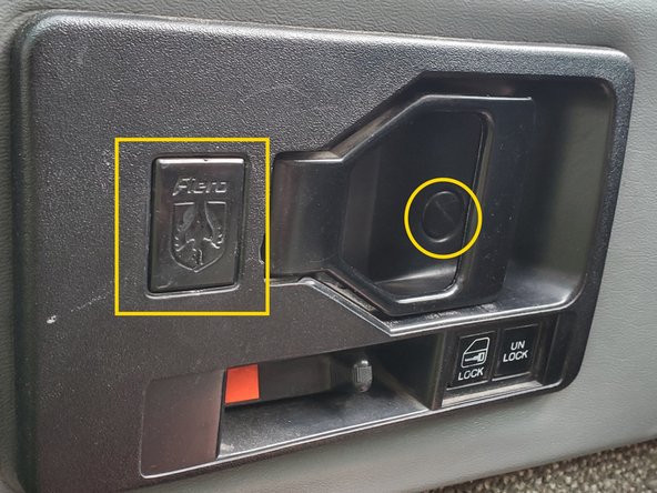

    • There are 3 screw covers to remove:
    • At the top of the door handle
    • The Fiero logo above the lock
    • Under the handle for opening the door
    • Simply use a flat screwdriver to "pop" the screw covers.
    • Be careful, Fiero's logo may jump quite far! Mine practically went on the passenger bench ;)

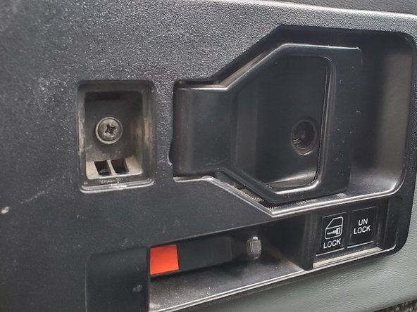

  2. Pontiac Fiero - Remove interior door panel, Remove the 5 screws: crwdns2935265:02crwdnd2935265:01crwdnd2935265:01crwdne2935265:0
    • Using a Phillips screwdriver, remove the 5 screws indicated in yellow.
    • After the 3 of the armrest, it will no longer hold after the door. You can put it aside.

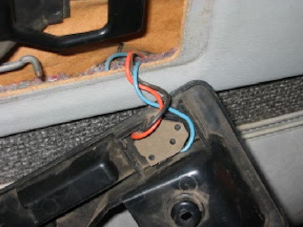

  3. Pontiac Fiero - Remove interior door panel, Remove the black module for door opening: crwdns2935265:03crwdnd2935265:01crwdnd2935265:02crwdne2935265:0 Pontiac Fiero - Remove interior door panel, Remove the black module for door opening: crwdns2935265:03crwdnd2935265:02crwdnd2935265:02crwdne2935265:0
    • Remove the black-orange latch by pulling it towards you.
    • Remove the entire black door opener module. Slide it forward to pass the handle.
    • You may have to detach the door lock buttons, if you have that option.
    • Images come from fierohoho, a member of Pennock's Fiero Forum at https://www.fiero.nl/forum/Forum9/HTML/0... d

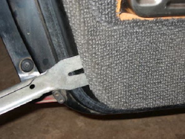

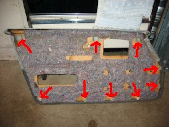

  4. Pontiac Fiero - Remove interior door panel, Remove Panel: crwdns2935265:04crwdnd2935265:01crwdnd2935265:03crwdne2935265:0 Pontiac Fiero - Remove interior door panel, Remove Panel: crwdns2935265:04crwdnd2935265:02crwdnd2935265:03crwdne2935265:0 Pontiac Fiero - Remove interior door panel, Remove Panel: crwdns2935265:04crwdnd2935265:03crwdnd2935265:03crwdne2935265:0
    • Detach the panel at the 9 points indicated by yellow arrows.
    • Either gently pull on the panel, by hand or you can use a prying tool.d
    • As the car ages, it is common for some fasteners to break. You can order new ones at https://www.fierostore.com/
    • The last 2 images come from fierohoho, a member of Pennock's Fiero Forum at https://www.fiero.nl/forum/Forum9/HTML/0...
