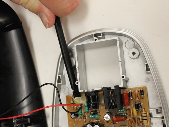

  6. Polyconcept 900-MHz Retro Cordless Telephone Device Motherboard Replacement, Removing Glue Covering for Wire Connections: crwdns2935265:06crwdnd2935265:01crwdnd2935265:02crwdne2935265:0 Polyconcept 900-MHz Retro Cordless Telephone Device Motherboard Replacement, Removing Glue Covering for Wire Connections: crwdns2935265:06crwdnd2935265:02crwdnd2935265:02crwdne2935265:0
    • Use the spudger tool to carefully scrape the glue off of the connection points of both the black and red wires.
  7. Polyconcept 900-MHz Retro Cordless Telephone Device Motherboard Replacement, Desoldering Wire Connections: crwdns2935265:07crwdnd2935265:01crwdnd2935265:01crwdne2935265:0
    • Gently lift the motherboard away from the base plate and flip over.
    • Use the soldering station to desolder the wire connections.
