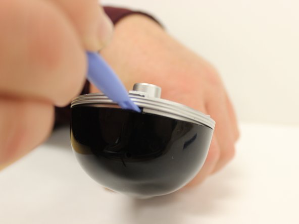

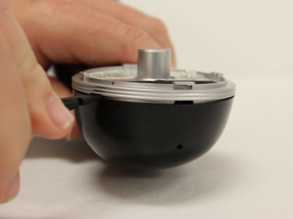

  5. Polyconcept 900-MHz Retro Cordless Telephone Device Microphone Replacement, Prying off the Microphone Cover: crwdns2935265:05crwdnd2935265:01crwdnd2935265:03crwdne2935265:0 Polyconcept 900-MHz Retro Cordless Telephone Device Microphone Replacement, Prying off the Microphone Cover: crwdns2935265:05crwdnd2935265:02crwdnd2935265:03crwdne2935265:0 Polyconcept 900-MHz Retro Cordless Telephone Device Microphone Replacement, Prying off the Microphone Cover: crwdns2935265:05crwdnd2935265:03crwdnd2935265:03crwdne2935265:0
    • Use the spudger to begin prying the microphone cover off of the handset piece.
    • As you pry up the cover, slide the spudger around the gap to separate the two pieces.
    • Use the opening tools to wedge into the larger gaps and further pry apart the pieces.
    • Prying apart the two pieces is difficult and will take effort. It helps if you wedge multiple tools on different sides of the gap. There is no need to be gentle.

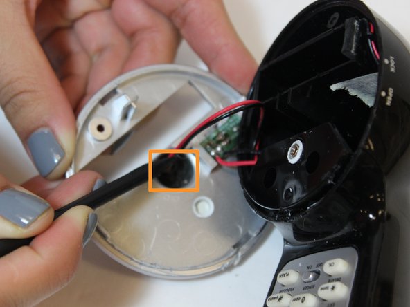

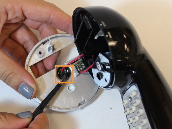

  6. Polyconcept 900-MHz Retro Cordless Telephone Device Microphone Replacement, Uncovering Wire Connections: crwdns2935265:06crwdnd2935265:01crwdnd2935265:03crwdne2935265:0 Polyconcept 900-MHz Retro Cordless Telephone Device Microphone Replacement, Uncovering Wire Connections: crwdns2935265:06crwdnd2935265:02crwdnd2935265:03crwdne2935265:0 Polyconcept 900-MHz Retro Cordless Telephone Device Microphone Replacement, Uncovering Wire Connections: crwdns2935265:06crwdnd2935265:03crwdnd2935265:03crwdne2935265:0
    • Use the spudger to scrape the glue away from the wire connections.
    • Use the spudger to scrape and tweezers to pull away the black foam covering the other wire connections.
  7. Polyconcept 900-MHz Retro Cordless Telephone Device Microphone Replacement, Desoldering Wire Connections: crwdns2935265:07crwdnd2935265:01crwdnd2935265:01crwdne2935265:0
    • Use the soldering station to desolder the wire connections.
