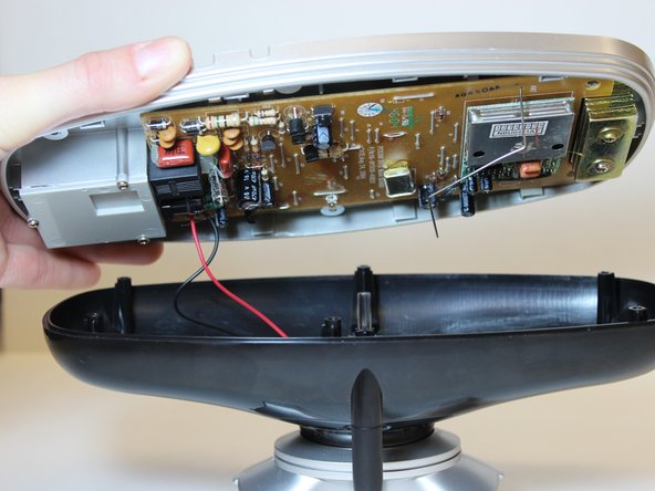

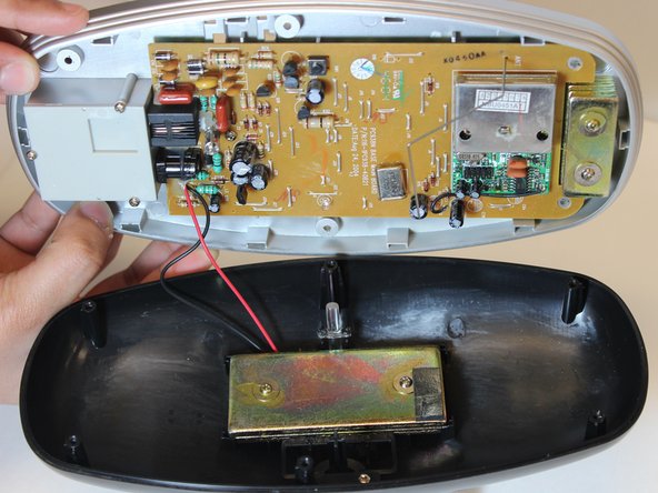

  3. Polyconcept 900-MHz Retro Cordless Telephone Device Charger Plate Replacement, Remove Bottom Plate from Base: crwdns2935265:03crwdnd2935265:01crwdnd2935265:03crwdne2935265:0 Polyconcept 900-MHz Retro Cordless Telephone Device Charger Plate Replacement, Remove Bottom Plate from Base: crwdns2935265:03crwdnd2935265:02crwdnd2935265:03crwdne2935265:0 Polyconcept 900-MHz Retro Cordless Telephone Device Charger Plate Replacement, Remove Bottom Plate from Base: crwdns2935265:03crwdnd2935265:03crwdnd2935265:03crwdne2935265:0
    • With the base turned upside down, grasp the edges of the base plate and gently lift from the rest of the base.
    • Two wires lead from the motherboard to the charger plate, so the two parts cannot be completely separated without further steps.

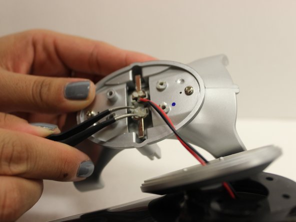

  8. Polyconcept 900-MHz Retro Cordless Telephone Device Charger Plate Replacement, Removing Glue from Wires: crwdns2935265:08crwdnd2935265:01crwdnd2935265:02crwdne2935265:0 Polyconcept 900-MHz Retro Cordless Telephone Device Charger Plate Replacement, Removing Glue from Wires: crwdns2935265:08crwdnd2935265:02crwdnd2935265:02crwdne2935265:0
    • Use the spudger to gently scrape the glue away from the wire connections.
    • If the spudger is not adequate, try using the tweezers to pull the glue away before scraping.
