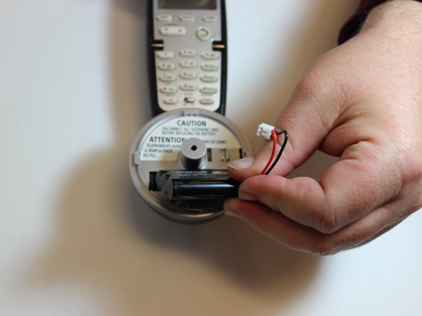

  1. Polyconcept 900-MHz Retro Cordless Telephone Device Battery Replacement, Removing the Battery Cover: crwdns2935265:01crwdnd2935265:01crwdnd2935265:03crwdne2935265:0 Polyconcept 900-MHz Retro Cordless Telephone Device Battery Replacement, Removing the Battery Cover: crwdns2935265:01crwdnd2935265:02crwdnd2935265:03crwdne2935265:0 Polyconcept 900-MHz Retro Cordless Telephone Device Battery Replacement, Removing the Battery Cover: crwdns2935265:01crwdnd2935265:03crwdnd2935265:03crwdne2935265:0
    • Hold the mouthpiece of the handset and locate the lock-unlock text.
    • Twist the battery cover counterclockwise from the "lock" to the "unlock" position.

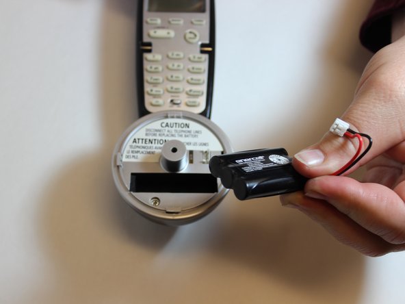

  2. Polyconcept 900-MHz Retro Cordless Telephone Device Battery Replacement, Disconnecting the Battery Wire: crwdns2935265:02crwdnd2935265:01crwdnd2935265:03crwdne2935265:0 Polyconcept 900-MHz Retro Cordless Telephone Device Battery Replacement, Disconnecting the Battery Wire: crwdns2935265:02crwdnd2935265:02crwdnd2935265:03crwdne2935265:0 Polyconcept 900-MHz Retro Cordless Telephone Device Battery Replacement, Disconnecting the Battery Wire: crwdns2935265:02crwdnd2935265:03crwdnd2935265:03crwdne2935265:0
    • To disconnect the battery pack wire from the phone, squeeze the tab against the connector and pull connector straight up from the socket.
  3. Polyconcept 900-MHz Retro Cordless Telephone Device Battery Replacement, Removing the Battery Pack: crwdns2935265:03crwdnd2935265:01crwdnd2935265:03crwdne2935265:0 Polyconcept 900-MHz Retro Cordless Telephone Device Battery Replacement, Removing the Battery Pack: crwdns2935265:03crwdnd2935265:02crwdnd2935265:03crwdne2935265:0 Polyconcept 900-MHz Retro Cordless Telephone Device Battery Replacement, Removing the Battery Pack: crwdns2935265:03crwdnd2935265:03crwdnd2935265:03crwdne2935265:0
    • Pull the battery from the battery compartment.
    • You may need to gently wiggle the battery back and forth in its compartment to help loosen it.
