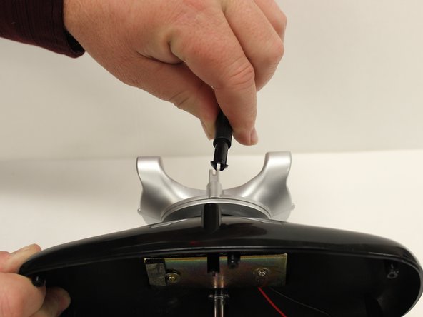

  1. Polyconcept 900-MHz Retro Cordless Telephone Device Antenna Replacement, Removing the Antenna Screw: crwdns2935265:01crwdnd2935265:01crwdnd2935265:03crwdne2935265:0 Polyconcept 900-MHz Retro Cordless Telephone Device Antenna Replacement, Removing the Antenna Screw: crwdns2935265:01crwdnd2935265:02crwdnd2935265:03crwdne2935265:0 Polyconcept 900-MHz Retro Cordless Telephone Device Antenna Replacement, Removing the Antenna Screw: crwdns2935265:01crwdnd2935265:03crwdnd2935265:03crwdne2935265:0
    • Inside the base cover, locate the screw holding the antenna in place and use a Philips #00 screwdriver to remove the 6mm screw.
  2. Polyconcept 900-MHz Retro Cordless Telephone Device Antenna Replacement, Removing the Antenna Foot: crwdns2935265:02crwdnd2935265:01crwdnd2935265:02crwdne2935265:0 Polyconcept 900-MHz Retro Cordless Telephone Device Antenna Replacement, Removing the Antenna Foot: crwdns2935265:02crwdnd2935265:02crwdnd2935265:02crwdne2935265:0
    • Grasp the plastic antenna foot and pull toward you.
  3. Polyconcept 900-MHz Retro Cordless Telephone Device Antenna Replacement, Removing the Antenna: crwdns2935265:03crwdnd2935265:01crwdnd2935265:02crwdne2935265:0 Polyconcept 900-MHz Retro Cordless Telephone Device Antenna Replacement, Removing the Antenna: crwdns2935265:03crwdnd2935265:02crwdnd2935265:02crwdne2935265:0
    • Pull antenna from the top side of the phone base cover.
    • It helps if you gently wiggle the antenna back and forth to loosen the clips.
