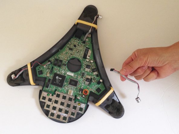

  3. Polycom SoundStation Microphone Replacement, Microphone: crwdns2935265:03crwdnd2935265:01crwdnd2935265:01crwdne2935265:0
    • Gently remove the yellow padding that covers the red and gray microphone wire on each phone leg.
  4. Polycom SoundStation Microphone Replacement: crwdns2935265:04crwdnd2935265:01crwdnd2935265:02crwdne2935265:0 Polycom SoundStation Microphone Replacement: crwdns2935265:04crwdnd2935265:02crwdnd2935265:02crwdne2935265:0
    • Gently pull up on the black plastic tab connected to the motherboard to disconnect each microphone.

I encountered an older version. Padding pieces are black. Microphones soldered on board with black & red wires, no plastic tab to disconnect
Putting the thing back together proved to be a challenge : the little display came apart and started shifting all over. Getting that one aligned inside while closing the thing with my fat fingers… . Nasty.
