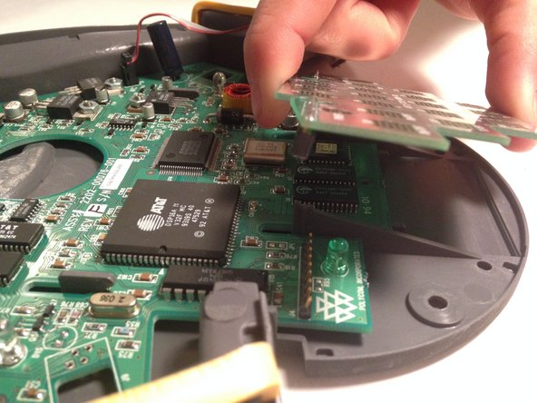

      • Gently lift and separate the back housing from the rest of the device. Now you've got the back housing off!
    1. Polycom SoundStation Internal Keyboard Replacement, Internal Keyboard: crwdns2935265:03crwdnd2935265:01crwdnd2935265:02crwdne2935265:0 Polycom SoundStation Internal Keyboard Replacement, Internal Keyboard: crwdns2935265:03crwdnd2935265:02crwdnd2935265:02crwdne2935265:0
      • Gently lift the internal keyboard off of the motherboard.
