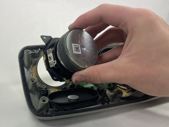

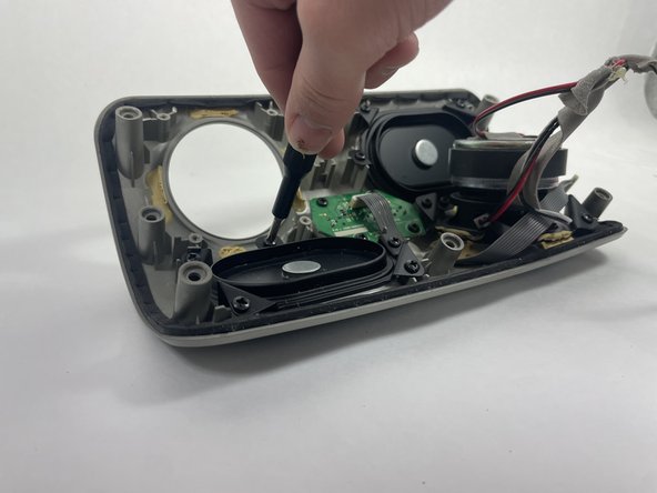

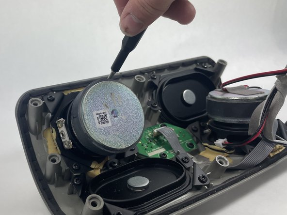

    • Use a Phillips #1 Screwdriver to remove the four 9.5 mm screws securing the driver.
    • The driver is magnetic, and will attract your screwdriver and screws. Unscrewing requires a bit of extra caution.
    • Remove the right driver.

    • Use a Phillips #1 screwdriver to remove the five 9.5 mm screws securing the radiator.
  8. Polk Omni S2 Right Radiator Replacement: crwdns2935265:08crwdnd2935265:01crwdnd2935265:01crwdne2935265:0
    • Remove the right radiator.
