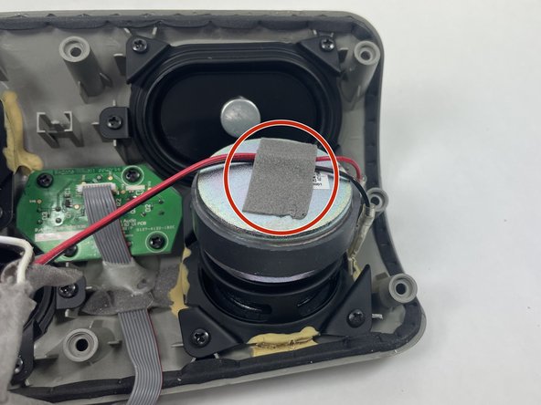

    • Remove the two square cotton pieces.
    • Unplug these three wires plugged into the motherboard by gently pulling and wiggling the wires until they're unplugged. Grip the wires close to the end to avoid damaging them.

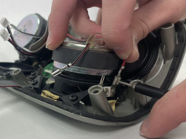

    • Remove the tape securing the two wires connected to the driver.
    • It helps to start under the portion of tape that's not stuck to the driver. Use a spudger if needed to pry the tape up without damaging it.
    • It's better not to damage the tape, but it's okay if you do. It can be replaced with any ordinary tape.

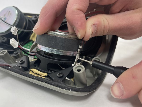

  5. Polk Omni S2 Left Radiator Replacement: crwdns2935265:05crwdnd2935265:01crwdnd2935265:03crwdne2935265:0 Polk Omni S2 Left Radiator Replacement: crwdns2935265:05crwdnd2935265:02crwdnd2935265:03crwdne2935265:0 Polk Omni S2 Left Radiator Replacement: crwdns2935265:05crwdnd2935265:03crwdnd2935265:03crwdne2935265:0
    • Use a spudger to push in the locking tab of the black wire while pulling up on it until it's unplugged.
    • Do the same for the red wire until it's unplugged.

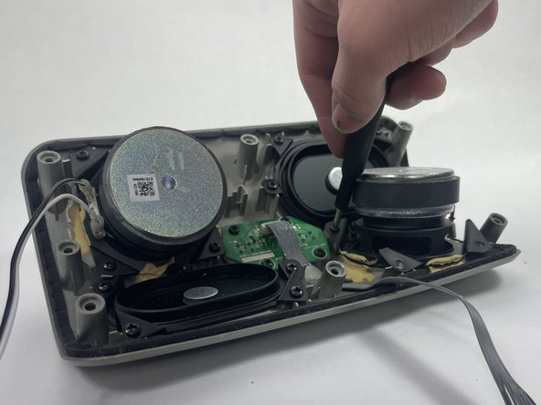

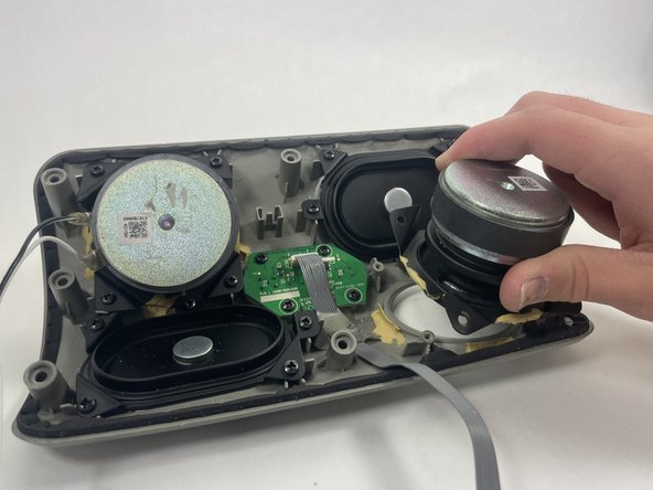

    • Use a Phillips #1 Screwdriver to remove the four 9.5 mm screws securing the driver.
    • The driver is magnetic, and will attract your screwdriver and screws. Unscrewing requires a bit of extra caution.
    • Remove the left driver.

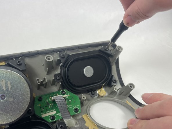

    • Use a Phillips #1 screwdriver to remove the five 9.5 mm screws securing the radiator.
  8. Polk Omni S2 Left Radiator Replacement: crwdns2935265:08crwdnd2935265:01crwdnd2935265:01crwdne2935265:0
    • Remove the left radiator.
