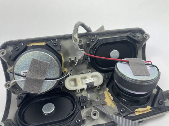

  3. Polk Omni S2 Front Three Buttons Replacement: crwdns2935265:03crwdnd2935265:01crwdnd2935265:03crwdne2935265:0 Polk Omni S2 Front Three Buttons Replacement: crwdns2935265:03crwdnd2935265:02crwdnd2935265:03crwdne2935265:0 Polk Omni S2 Front Three Buttons Replacement: crwdns2935265:03crwdnd2935265:03crwdnd2935265:03crwdne2935265:0
    • Remove the two square cotton pieces.
    • Unplug these three wires plugged into the motherboard by gently pulling and wiggling the wires until they're unplugged. Grip the wires close to the end to avoid damaging them.

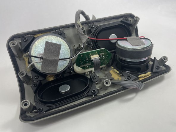

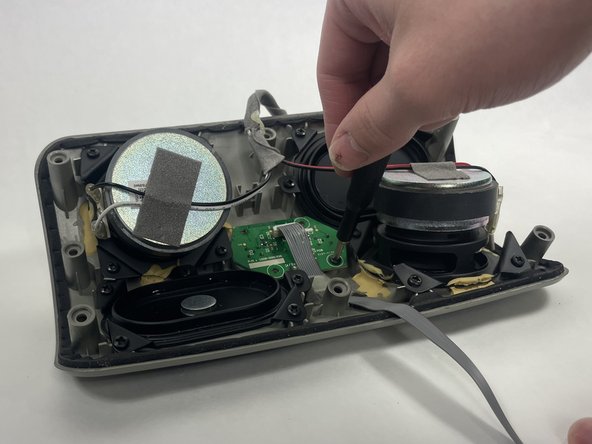

  4. Polk Omni S2 Front Three Buttons Replacement, Front Three Buttons: crwdns2935265:04crwdnd2935265:01crwdnd2935265:03crwdne2935265:0 Polk Omni S2 Front Three Buttons Replacement, Front Three Buttons: crwdns2935265:04crwdnd2935265:02crwdnd2935265:03crwdne2935265:0 Polk Omni S2 Front Three Buttons Replacement, Front Three Buttons: crwdns2935265:04crwdnd2935265:03crwdnd2935265:03crwdne2935265:0
    • Remove the four 9.5 mm screws securing the button daughterboard to the front cover using a Phillips #1 screwdriver.
    • The drivers are magnetic, and will attract your screwdriver and screws. Unscrewing requires a bit of extra caution.
  5. Polk Omni S2 Front Three Buttons Replacement: crwdns2935265:05crwdnd2935265:01crwdnd2935265:02crwdne2935265:0 Polk Omni S2 Front Three Buttons Replacement: crwdns2935265:05crwdnd2935265:02crwdnd2935265:02crwdne2935265:0
    • Grab the gray ribbon cable as close to the connector as possible and gently wiggle and pull until it's unplugged from the button daughterboard.
    • The gray ribbon cable does not need to be removed. Leave it secured to the front cover.
