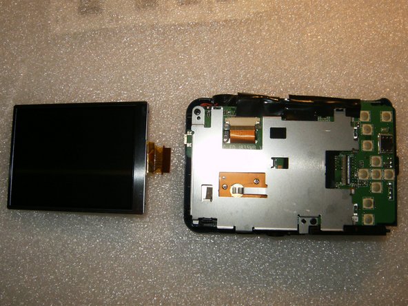

    • remove the batteries, the memory card as well as the carrying strip (if so equipped).
    • Remove the 2 screws on the right hand side.
    • Remove the 2 screws on the left hand side.
  2. Polaroid i835 LCD Replacement: crwdns2935265:02crwdnd2935265:01crwdnd2935265:03crwdne2935265:0 Polaroid i835 LCD Replacement: crwdns2935265:02crwdnd2935265:02crwdnd2935265:03crwdne2935265:0 Polaroid i835 LCD Replacement: crwdns2935265:02crwdnd2935265:03crwdnd2935265:03crwdne2935265:0
    • One more screw on the bottom, underneath the manufacturer's label.
    • Start spitting the case from the battery compartment. You can use a plastic opening tool, or your finger nails. It does bind a bit at the USB port side, but will separate pretty quick.
    • With the back removed, the large LCD becomes immediately visible. There are no fasteners, it just rests inside the tray.
  3. Polaroid i835 LCD Replacement: crwdns2935265:03crwdnd2935265:01crwdnd2935265:02crwdne2935265:0 Polaroid i835 LCD Replacement: crwdns2935265:03crwdnd2935265:02crwdnd2935265:02crwdne2935265:0
    • Lift the LCD out of the tray and move it to the right of the tray. The cable is still attached to the logic board via a latch.
    • With the plastic opening tool, or your fingernails, gently flip the latch to the left side. This will free the LCD cable. Remove the LCD and install your new one.
