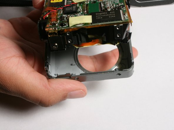

  4. Polaroid i533 Zoom Lens Replacement, Removing screws on logic board: crwdns2935265:04crwdnd2935265:01crwdnd2935265:02crwdne2935265:0 Polaroid i533 Zoom Lens Replacement, Removing screws on logic board: crwdns2935265:04crwdnd2935265:02crwdnd2935265:02crwdne2935265:0
    • Using the Phillips #00 screwdriver, unscrew and remove the (3mm) screw on the bottom of the logic board above the tripod mount. Keep the screw for reassembly.
    • Gently pull the front of the case off.

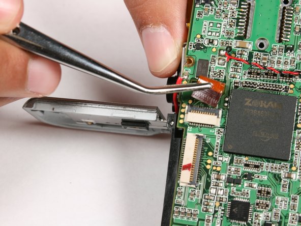

  6. Polaroid i533 Zoom Lens Replacement, Removing zoom lens ribbon: crwdns2935265:06crwdnd2935265:01crwdnd2935265:02crwdne2935265:0 Polaroid i533 Zoom Lens Replacement, Removing zoom lens ribbon: crwdns2935265:06crwdnd2935265:02crwdnd2935265:02crwdne2935265:0
    • Using tweezers gently lift the black tab that holds the zoom lens ribbon in place.
    • Gently remove the zoom lens ribbon.

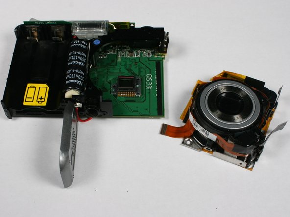

  8. Polaroid i533 Zoom Lens Replacement: crwdns2935265:08crwdnd2935265:01crwdnd2935265:02crwdne2935265:0 Polaroid i533 Zoom Lens Replacement: crwdns2935265:08crwdnd2935265:02crwdnd2935265:02crwdne2935265:0
    • It is now safe for you to remove the zoom lens.
    • To reassemble the device, follow these steps in reverse.
