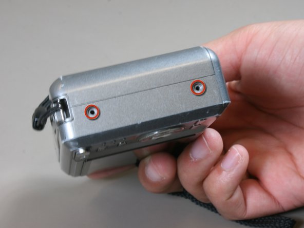

    • Unscrew and remove the two screws from the right side of the camera.

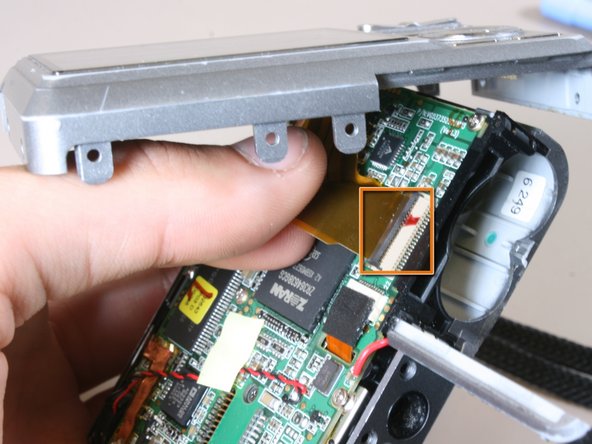

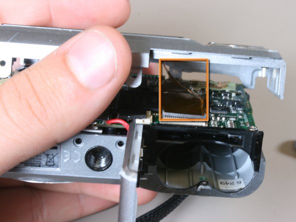

  8. Polaroid i533 Outer Case Replacement: crwdns2935265:08crwdnd2935265:01crwdnd2935265:02crwdne2935265:0 Polaroid i533 Outer Case Replacement: crwdns2935265:08crwdnd2935265:02crwdnd2935265:02crwdne2935265:0
    • Use a spudger to lift the black flap that clamps the ribbon towards you.
    • When the black flap is open it will be straight up. (like in the second picture)
