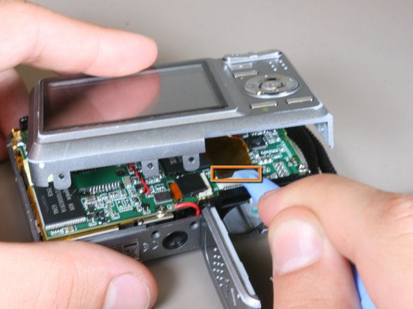

  4. Polaroid i533 LCD Screen Replacement: crwdns2935265:04crwdnd2935265:01crwdnd2935265:02crwdne2935265:0 Polaroid i533 LCD Screen Replacement: crwdns2935265:04crwdnd2935265:02crwdnd2935265:02crwdne2935265:0
    • Locate where the LCD screen ribbon is attached to the logic board.
    • Using the iFixit plastic opening tool, flip up the black tab that connects the LCD screen ribbon to the motherboard.
  5. Polaroid i533 LCD Screen Replacement: crwdns2935265:05crwdnd2935265:01crwdnd2935265:01crwdne2935265:0
    • Gently pull the ribbon away from the motherboard. This will allow the cover to separate from the rest of the camera.
