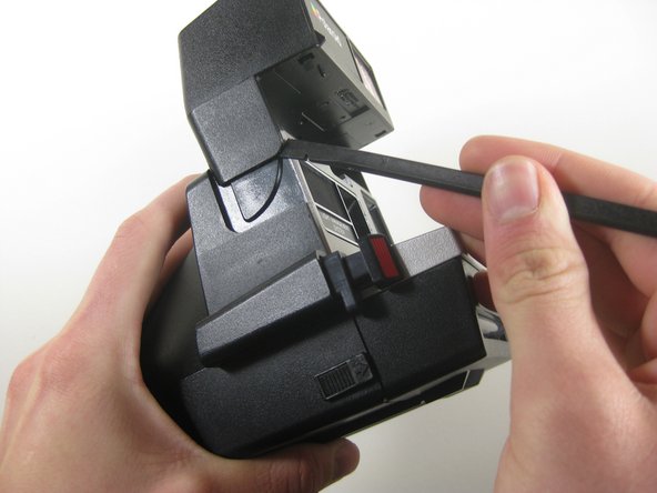

  3. Polaroid Sun 600 LMS Lens Replacement: crwdns2935265:03crwdnd2935265:01crwdnd2935265:02crwdne2935265:0 Polaroid Sun 600 LMS Lens Replacement: crwdns2935265:03crwdnd2935265:02crwdnd2935265:02crwdne2935265:0
    • Use a spudger on each side to separate the flash segment from the main body.
    • Be careful not to do this too hard because you may pull out the connecting wires.

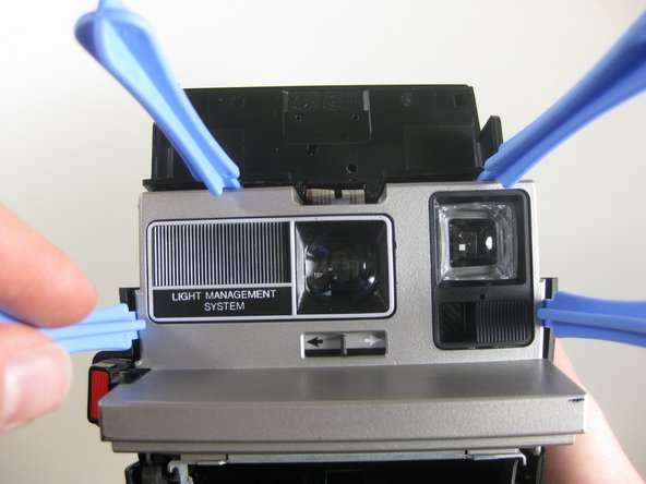

  4. Polaroid Sun 600 LMS Lens Replacement: crwdns2935265:04crwdnd2935265:01crwdnd2935265:02crwdne2935265:0 Polaroid Sun 600 LMS Lens Replacement: crwdns2935265:04crwdnd2935265:02crwdnd2935265:02crwdne2935265:0
    • Use several plastic opening tools around the edges of the camera's body to separate it from the plastic frame.

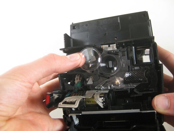

  6. Polaroid Sun 600 LMS Lens Replacement: crwdns2935265:06crwdnd2935265:01crwdnd2935265:02crwdne2935265:0 Polaroid Sun 600 LMS Lens Replacement: crwdns2935265:06crwdnd2935265:02crwdnd2935265:02crwdne2935265:0
    • Carefully remove the damaged lens from the interior of the camera.
    • Replace with a new lens.
