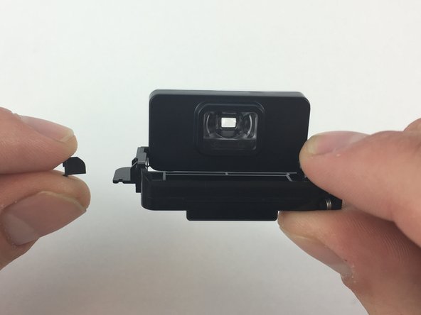

  6. Polaroid SNAP View Finder Replacement, View Finder: crwdns2935265:06crwdnd2935265:01crwdnd2935265:02crwdne2935265:0 Polaroid SNAP View Finder Replacement, View Finder: crwdns2935265:06crwdnd2935265:02crwdnd2935265:02crwdne2935265:0
    • Gently grasp the view finder (while in the closed position) with your thumb and fore finger. Then carefully pull the viewfinder outwards.
  7. Polaroid SNAP View Finder Replacement: crwdns2935265:07crwdnd2935265:01crwdnd2935265:02crwdne2935265:0 Polaroid SNAP View Finder Replacement: crwdns2935265:07crwdnd2935265:02crwdnd2935265:02crwdne2935265:0
    • Once the view finder is out, a small black tab should come loose from the viewfinder. Insert this small black tab in to the hole on the side of the new view finder, with the round side up.
