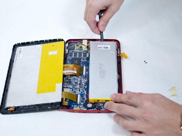

  4. Polaroid S7 Battery Replacement: crwdns2935265:04crwdnd2935265:01crwdnd2935265:02crwdne2935265:0 Polaroid S7 Battery Replacement: crwdns2935265:04crwdnd2935265:02crwdnd2935265:02crwdne2935265:0
    • Use the metal spudger to remove the three pieces of clear tape adhering from the battery to the blue board.
    • Pry the battery up from the right side.
