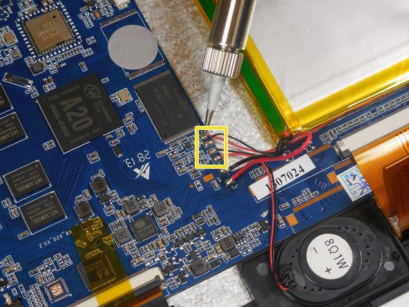

  3. Polaroid S10 Speaker Replacement, Desoldering the Speakers: crwdns2935265:03crwdnd2935265:01crwdnd2935265:02crwdne2935265:0 Polaroid S10 Speaker Replacement, Desoldering the Speakers: crwdns2935265:03crwdnd2935265:02crwdnd2935265:02crwdne2935265:0
    • Carefully desolder the 4 connections of the speakers.
    • Do not touch the soldering iron to the motherboard or LCD screen.
